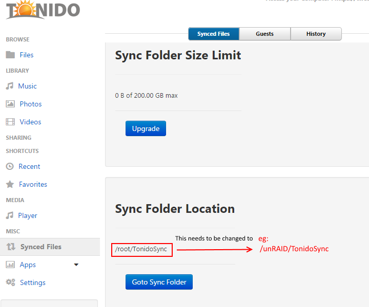

I think I found the answer to your problem:
The Sync Plugin of Tonido is set such that the Sync Folder location is "/root/TonidoSync" by default, but we want the Sync folder location to be a subfolder of /unRAID.
See my attached image for an example and follow the instructions here to change the location of your sync folder to be a subfolder of /unRAID.
On my system (yours will vary) the location of the xml to be changed was
/mnt/cache/Docker/AppData/Tonido/profiles\<myprofile>\plugindata\syncserver\syncserverconfig.xml
stop the docker, edit the file changing
      <rowentry>
         <name>syncfolderlocation</name>
         <type>string</type>
         <value>DEFAULT</value>
       </rowentry>
to
      <rowentry>
         <type>string</type>
         <value>/unRAID/TonidoFiles/Sync</value>
       </rowentry>
Save file and restart Tonido Docker. Check that folder location is now correctly showing new location.
Should work now.
the Capt.

tried it
still showing up as root not unraid
I will double check my file and post
Success!!!
helps if you edit the correct path. :) :) :) :) :) :)

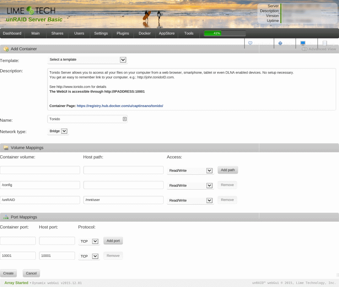

Is there a setup guide for Tonido on unRAID? For example, could someone chime in on what values need to be entered into each of the fields in the setup page for the Tonido Docker container (see attached image)? -- I've included text headings below to facilitate easy copy/paste response.
Also, I assume that port forwarding needs to be set up in each individual's network's router. To which port(s)? (multiple are listed in the setup page)
Thanks,
Ari

Unless you have a particular reason to change them, the defaults loaded with a Docker template usually work well. Changing the volume mappings may be required depending on your particular server configuration and use for the Docker.
-- Add Container --
Name: [does this matter?] doesn't matter but this is the name that you will see in the Docker tab
Network Type: default (Bridge)
-- Volume Mappings --
Container Volume: /config
Host Path: path to your docker's app data. if you're using a cache drive then it's typically /mnt/cache/appdata/tonido
Access: this should always be Read/Write
Container Volume: a unique path name that will show up in the Docker. /UnRAID is fine or you can call it something else (/media, /files, etc.)
Host Path: depends on what you want to access. /mnt/user will provide access to all user shares.
Access: Read only if you just want users be able to download individual files. Read/Write if you want users to be able to download multiple files or folders or want them to be able to delete files/folders from Tonido
Container Volume:
Host Path:
Access:
-- Port Mappings --
Container Port: default (10001) unless it is already in use
Host Port: default (10001)
Protocol: default (TCP)
Container Port:
Host Port:
Protocol:
Tonido doesn't require port forwarding. You make an account at tonidoid.com and use that address to access your docker.
Thank you, using the defaults and then adding the following was all that was needed
After that, I went into the Docker tab, clicked on the Tonido icon, and set up an account. After that, there was a wizard to guide me through the rest.
Thanks for the help,
Ari
