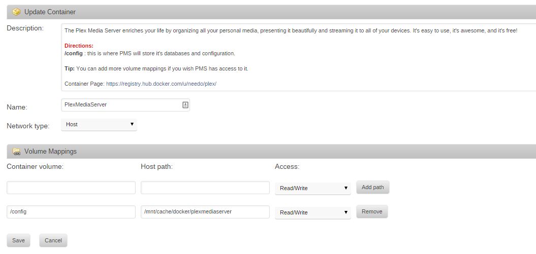

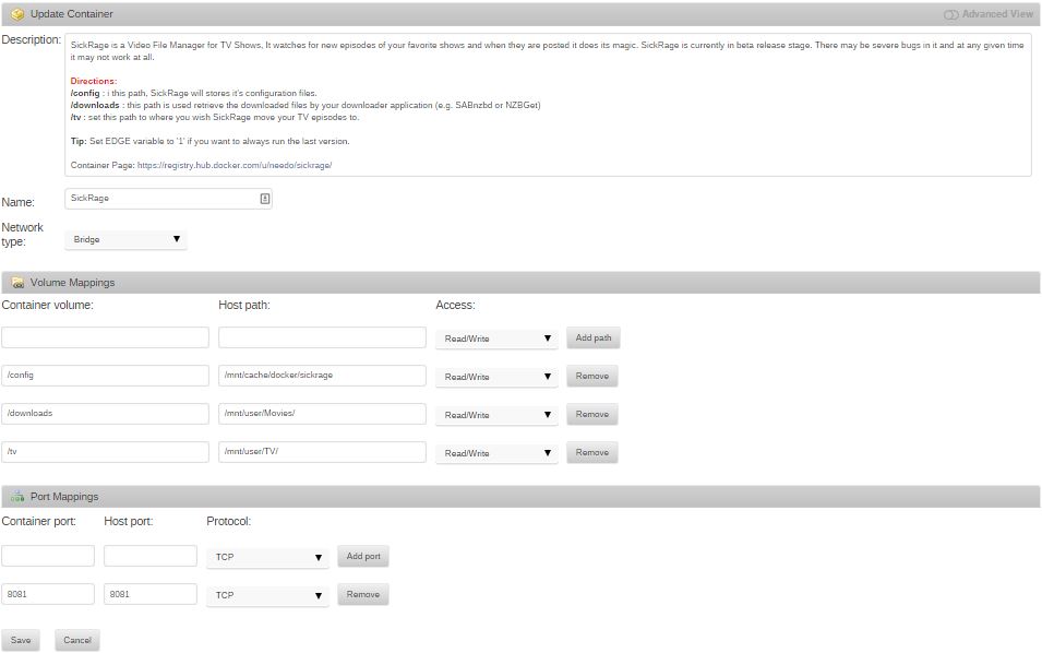

Maybe post a picture up of the port mappings for both those containers.
Also, it may take a bit for the UI to become active, as the containers may be downloading any updates, etc prior to launching the container
Post a screenshot of the whole Docker page.
So far its a pretty vanilla setup, but here are the screenshots
I don't use sickrage, but I am using needo's plex. You don't have any volume mapping to allow plex access to any of your media files.

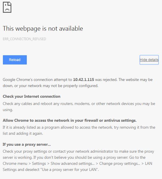

How are you trying to get to Plex? If you click on the Plex icon on the docker page it will give you a link to the WebUI.
I have been trying to access via the local name and the ip address.  I have tried launching from the docker as well, but no real luck.
I am having the same issue with Plex Media Server... after installing/starting the Plex container. I used the same path as screencap above...and after the docker is running, this folder remains empty. I have a feeling there is something I am missing about an appdata share... Can someone please shed light on this.
I also added /mnt path connected to host path /mnt/
Any help is greatly appreciated.
My screncap:
I've been trying to go via the WebUI.
http://10.42.1.115:32400/web/index.html
http://[[server Name]]:32400/web/index.html
When you click on the icon for your plex docker, there is a popup that let's you go to the WebUI for plex. One of the other choices in that popup is the log for that docker. What does it say?
