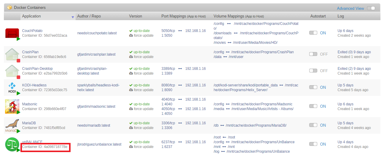

I updated and I am getting on the home screen:
"The array is not operational. Please start the array first."
My array is running. In settings, I have folders
/Media/Movies
/Media/TV
That are in:
/mnt/user/Media/Movies
/mnt/user/Media/TV
This is what is in Unbalance's log on the Dockers page:

unBalance is causing Cron errors for me, almost daily.
I didn't used to leave it running, so I didn't have the issue, but lately I have been.
I am getting the following e-mailed to me:
Cron <root@4a098718778e> test -x /usr/sbin/anacron || ( cd / && run-parts --report /etc/cron.daily )
/etc/cron.daily/logrotate:
invoke-rc.d: policy-rc.d denied execution of reload.
This has eluded me for a while, however I have (with help) pinpointed the problem to this docker!
The container ID on the docker page is identical to the one in the "root@4a098718778e" part.
Screenshot attached.
I was bitching about it plenty in this thread: http://lime-technology.com/forum/index.php?topic=40151.msg378553#msg378553
Hi bungee91,
It looks like having a mail daemon in the docker container, triggers the email when logrotate fails.
The question now is why logrotate is failing and more important, why is it running at all.
I'll have a look at the phusion base image to find out more about it.
Released an update that should prevent the mail notification.
bungee91, please try it and let me know how it goes.
