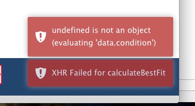

I have had this issue for a while and wanted to try and figure out why i am getting this error.  I have set up all of my directories and a few of the drives will move correctly.  however some give me the error message "undefined is not an object (evaluating 'data.condition')  Followed up with XHR failed for calculateBestFit.  Any ideas what is wrong.
Hi derbtv,
From the log I see that it crashes trying to read some folder located at /mnt/disk8/ISOImages.
If you're ok with dropping to the command line, would you try these two commands:
ls -al /mnt/disk8/ISOImages
to check ownership/permissions. Ownership should be nobody:users and permissions should allow the file/folder to be read
du -bs /mnt/disk8/ISOImages/*
that's the command the app is crashing on, so it would be nice to see what it's actually doing

ls -al /mnt/disk8/ISOImages[/code
drwxrwxrwx  3 nobody users  80 Feb 11  2014 ./
drwxrwxrwx 13 nobody users 312 May 10 09:13 ../
drwxrwxrwx  3 nobody users 112 May 10 19:40 .TemporaryItems/
du: cannot access ‘/mnt/disk8/ISOImages/*’: No such file or directory
thanks
Welp we have it figured out.  It is the freaking temp files created by my mac.  I have deleted all of them and it is working as expected..  Thanks I do have another question.. When some drives it tells me that it is going to completely free up and others it only clears up a portion.  Any ideas how to tell what it is not going to move and why?

The container reads it as owned by root as mentioned before (filesystem: rootfs, mounted on: /mnt)
- Format the drive
- Open unBALANCE
At this point, unBALANCE is doomed :)
But if you restart the container here, it will read the right data.
Restarting the array also works because it stops/starts the containers, and this time the drive is formatted so it can be read properly.
I'm looking at some alternatives, but none is very promising to be honest.
In any case, let me know if restarting the container does it for you.
Ya, that works for me.
I feel bad for finding an issue with this awesome product.    It isn't a big deal, and the work around is reasonable.
I'm glad you replicated the issue, cause I don't have any more drives to do now.

I seem to be doing something wrong, but don't know exactly what;
I: 2015/06/19 11:02:14 core.go:220: =========================================================
I: 2015/06/19 11:02:14 core.go:221: Results for /mnt/disk7
I: 2015/06/19 11:02:14 core.go:222: Original Free Space: 45.8G
I: 2015/06/19 11:02:14 core.go:223: Final Free Space: 45.8G
I: 2015/06/19 11:02:14 core.go:224: Gained Space: 0
I: 2015/06/19 11:02:14 core.go:225: Bytes To Move: 0
I: 2015/06/19 11:02:14 core.go:226: ---------------------------------------------------------
I: 2015/06/19 11:02:14 unraid.go:224: Unraid Box Condition: &{NumDisks:19 NumProtected:19 Synced:2015-05-24 03:58:45 +0100 BST SyncErrs:0 Resync:0 ResyncPrcnt:0 ResyncPos:0 State:STARTED Size:42002025897984 Free:3412631412736 NewFree:3412631412736}
I: 2015/06/19 11:02:14 unraid.go:225: Unraid Box SourceDiskName: /mnt/disk7
I: 2015/06/19 11:02:14 unraid.go:226: Unraid Box BytesToMove: 0
I: 2015/06/19 11:02:14 unraid.go:237: Id(1); Name(md1); Path(/mnt/disk1); Device(sdk), Free(91.4G); NewFree(91.4G); Size(1.8T); Serial(SAMSUNG_HD204UI_S2HGJ1BZ809431); Status(DISK_OK); Bin()
I: 2015/06/19 11:02:14 unraid.go:237: Id(2); Name(md2); Path(/mnt/disk2); Device(sdh), Free(174.1G); NewFree(174.1G); Size(1.8T); Serial(SAMSUNG_HD204UI_S2H7J9BB314796); Status(DISK_OK); Bin()
I: 2015/06/19 11:02:14 unraid.go:237: Id(3); Name(md3); Path(/mnt/disk3); Device(sdm), Free(108.6G); NewFree(108.6G); Size(1.8T); Serial(SAMSUNG_HD204UI_S2HGJ1AZ801549); Status(DISK_OK); Bin()
I: 2015/06/19 11:02:14 unraid.go:237: Id(4); Name(md4); Path(/mnt/disk4); Device(sde), Free(168.7G); NewFree(168.7G); Size(1.8T); Serial(SAMSUNG_HD204UI_S2HGJ1BZ809429); Status(DISK_OK); Bin()
I: 2015/06/19 11:02:14 unraid.go:237: Id(5); Name(md5); Path(/mnt/disk5); Device(sdp), Free(173.2G); NewFree(173.2G); Size(1.8T); Serial(SAMSUNG_HD204UI_S2H7J9BB314797); Status(DISK_OK); Bin()
I: 2015/06/19 11:02:14 unraid.go:237: Id(6); Name(md6); Path(/mnt/disk6); Device(sdg), Free(173.6G); NewFree(173.6G); Size(1.8T); Serial(SAMSUNG_HD204UI_S2HGJ1BZ809518); Status(DISK_OK); Bin()
I: 2015/06/19 11:02:14 unraid.go:237: Id(7); Name(md7); Path(/mnt/disk7); Device(sdn), Free(45.8G); NewFree(45.8G); Size(1.8T); Serial(WDC_WD20EARS-00MVWB0_WD-WCAZA3122490); Status(DISK_OK); Bin()
I: 2015/06/19 11:02:14 unraid.go:237: Id(; Name(md8); Path(/mnt/disk8); Device(sds), Free(275.4G); NewFree(275.4G); Size(1.8T); Serial(WDC_WD20EARS-00J99B0_WD-WCAWZ0732007); Status(DISK_OK); Bin()
I: 2015/06/19 11:02:14 unraid.go:237: Id(9); Name(md9); Path(/mnt/disk9); Device(sdu), Free(114.4G); NewFree(114.4G); Size(1.8T); Serial(WDC_WD20EARX-00PASB0_WD-WMAZA6830041); Status(DISK_OK); Bin()
I: 2015/06/19 11:02:14 unraid.go:237: Id(10); Name(md10); Path(/mnt/disk10); Device(sdq), Free(87.1G); NewFree(87.1G); Size(1.8T); Serial(Hitachi_HDS5C3020ALA632_ML0230FA0LKK5D); Status(DISK_OK); Bin()
I: 2015/06/19 11:02:14 unraid.go:237: Id(11); Name(md11); Path(/mnt/disk11); Device(sdo), Free(144.3G); NewFree(144.3G); Size(1.8T); Serial(SAMSUNG_HD204UI_S2HGJ1AZ801624); Status(DISK_OK); Bin()
I: 2015/06/19 11:02:14 unraid.go:237: Id(12); Name(md12); Path(/mnt/disk12); Device(sdf), Free(190G); NewFree(190G); Size(2.7T); Serial(WDC_WD30EFRX-68EUZN0_WD-WCC4N0964192); Status(DISK_OK); Bin()
I: 2015/06/19 11:02:14 unraid.go:237: Id(13); Name(md13); Path(/mnt/disk13); Device(sdc), Free(250G); NewFree(250G); Size(2.7T); Serial(WDC_WD30EFRX-68AX9N0_WD-WMC1T0907311); Status(DISK_OK); Bin()
I: 2015/06/19 11:02:14 unraid.go:237: Id(14); Name(md14); Path(/mnt/disk14); Device(sdb), Free(347.9G); NewFree(347.9G); Size(2.7T); Serial(WDC_WD30EFRX-68EUZN0_WD-WMC4N1345473); Status(DISK_OK); Bin()
I: 2015/06/19 11:02:14 unraid.go:237: Id(15); Name(md15); Path(/mnt/disk15); Device(sdj), Free(261.9G); NewFree(261.9G); Size(2.7T); Serial(WDC_WD30EFRX-68AX9N0_WD-WCC1T0826380); Status(DISK_OK); Bin()
I: 2015/06/19 11:02:14 unraid.go:237: Id(16); Name(md16); Path(/mnt/disk16); Device(sdi), Free(174.8G); NewFree(174.8G); Size(2.7T); Serial(WDC_WD30EFRX-68AX9N0_WD-WMC1T1079164); Status(DISK_OK); Bin()
I: 2015/06/19 11:02:14 unraid.go:237: Id(17); Name(md17); Path(/mnt/disk17); Device(sdr), Free(183.3G); NewFree(183.3G); Size(1.8T); Serial(Hitachi_HDS5C3020ALA632_ML0220F3112GAD); Status(DISK_OK); Bin()
I: 2015/06/19 11:02:14 unraid.go:237: Id(18); Name(md18); Path(/mnt/disk18); Device(sdl), Free(213.6G); NewFree(213.6G); Size(2.7T); Serial(WDC_WD30EZRX-00MMMB0_WD-WCAWZ1895639); Status(DISK_OK); Bin()
I: 2015/06/19 11:02:14 core.go:232: calculateBestFit:End:srcDisk(/mnt/disk7)
Folders Selected
# Folder
/mnt/user/movies
/mnt/user/series
and from ssh I show this on the drive
root@Tower:/mnt/disk7# ls -ltr
total 1
drwxrwxrwx 11 nobody users 288 Jul 18  2011 movies/
drwxrwxrwx 19 nobody users 624 May  1 23:13 series/
but it says nothing to do
Folders Selected
# Folder
/mnt/user/movies
/mnt/user/series
Do you mean you entered movies and series as folders or actually /mnt/user/movies and /mnt/user/series ?
The former would be the way to enter them (I'm working on enabling a dropdown as suggested by glave, so this would become a non-issue).
If that's not the case, do you see in the logs any lines similar to this
calculateBestFit:total(xxx):toBeMoved:Path(yyy); Size(zzz)
you were correct lboregard, I entered the full path and not the names for movies and series, it is now doing the calculations
