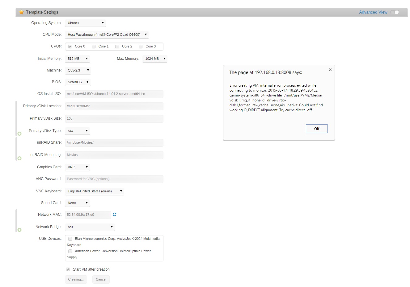

Decided I'd try my first VM and believe I've followed instructions, but continue to fail with the same message no matter what I try (image attached).  Believe motherboard is visualization capable albeit the only option in the bios is called "Vanderpool Technology" , it's an Asus Maximus Formula with the latest BIOS.  Any help appreciated
Can you try mapping your storage to a disk share or cache specifically instead of through the user share?  e.g. /mnt/disk1/someshare or /mnt/cache/someshare
Thanks Jon... I did create a  share on cache drive only...
Thanks jonp that was indeed my problem.
Wow...  :o
To answer my own question.... I connected my existing Ubuntu Server  HD to a computer, where I had another hard drive as weel (my Windows machine). I booted with Parted Magic and I dd the entire Ubuntu drive into a .img file.
I booted windows and I copied the image file into a subdirectory inside my VM directory. I went to add a VM in unRAID Web GUI, I picked the image file as Primary vDisk Location. Started it and I have my old Ubuntu server running!!
