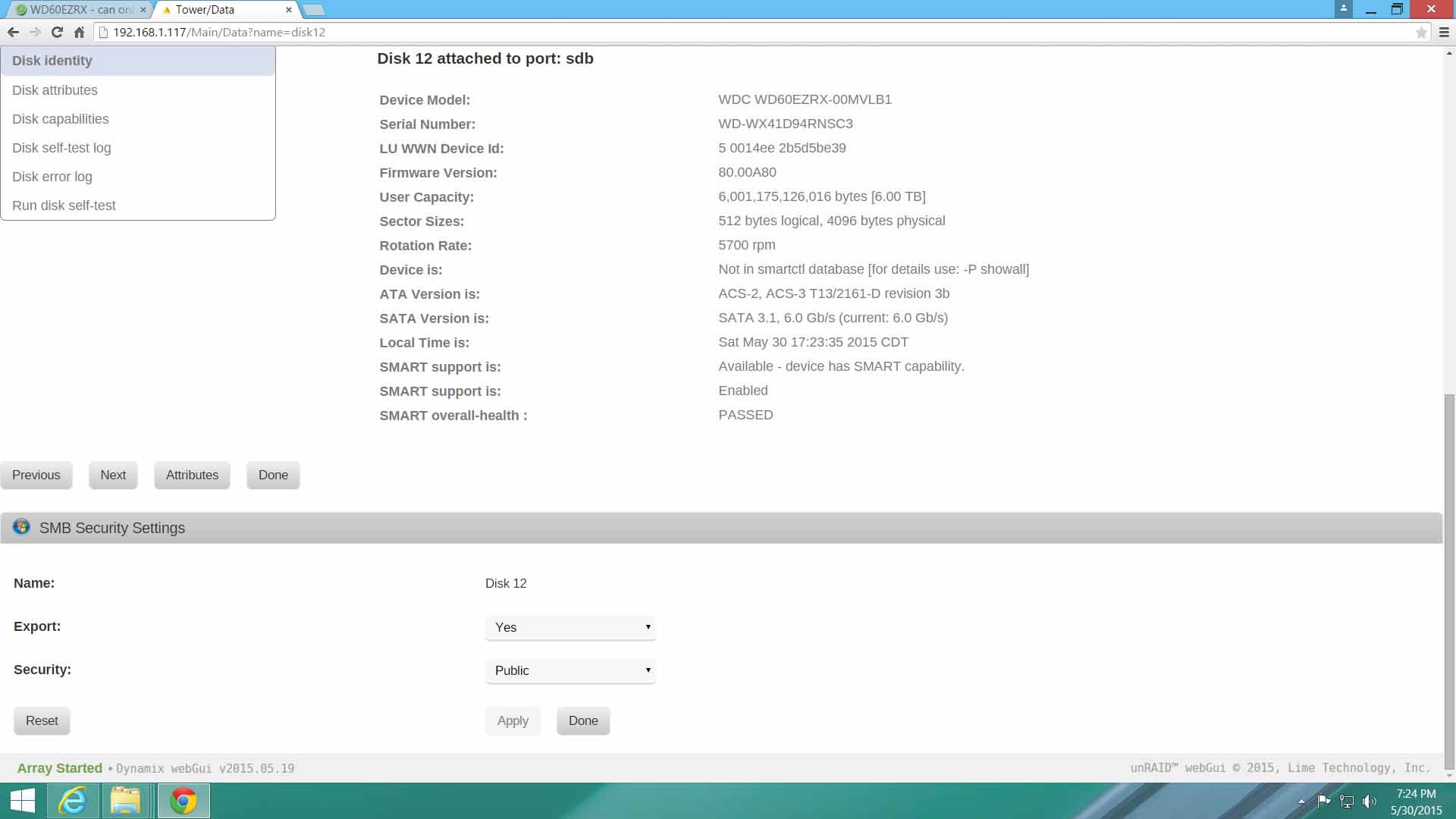

Your writing to disk13 disk share and we have not yet seen the config for the disk13 share. Reply 21 shows the top portion of the disk page. The disk share configuration is shown on the bottom of the page. Please show the disk share config for the drive in question.
Please note that the issue is with D12 [it was with D13 prior to me removing the 'old' D12 and then moving D13 to the D12 slot].
However, both drives exhibited the same behavior.
Is the following attachment what you require?

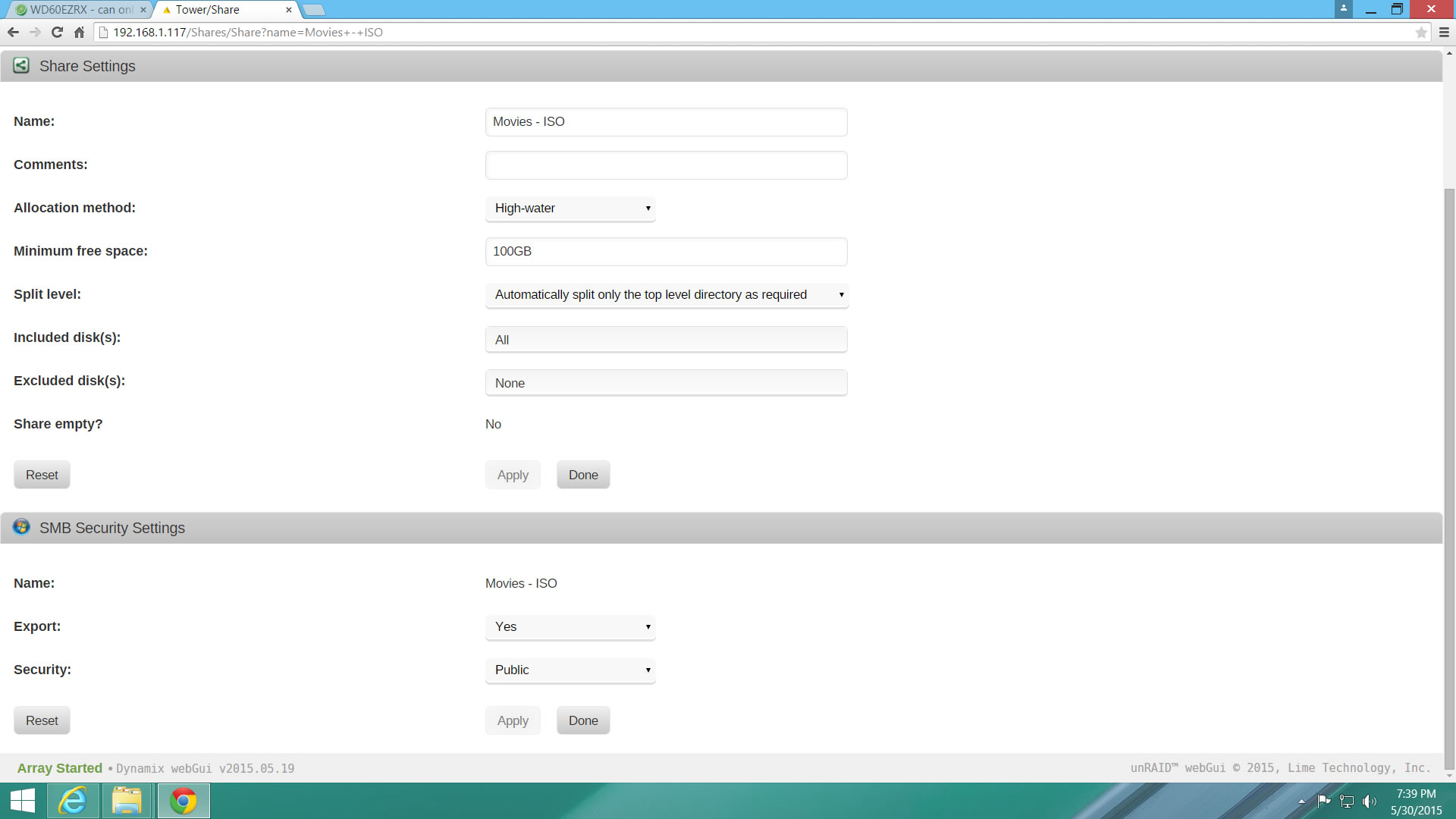

It's set to split level 1, High-water, 100GB min free space.

Correct on all points except my share name is 'Movies - ISO'. Every copy attempt has been to the same share.
Created 'test share' as instructed and the 40+ GB file copies just fine if I just dump it to the share AS WELL AS copying to D12\test share (tried it both ways). Copy speeds even look good @ 100+ MB/s.
I was totally shocked as I fully expected it to fail.
Is it possible this has something to do with the name of my share?
And, yes, this is extremely frustrating but at the very least we know a work-around.
So I went ahead a copied another 40+ GB file to 'test share' and it copied no problem.
Then I tried to copy the same file to d12\Movies - ISO again and it triggered the error.

It seems like the issue is simply the name of your share.  Try simply renaming it ... perhaps without the "-" in case the special character is causing some issue ... e.g. "Movie ISOs"
