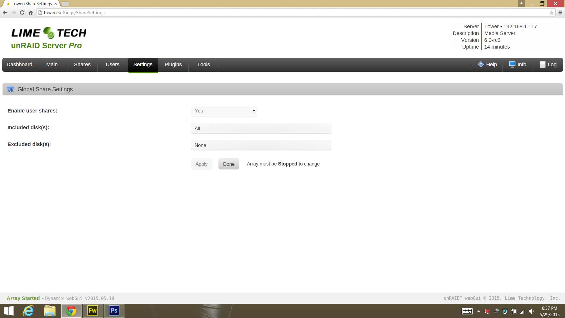

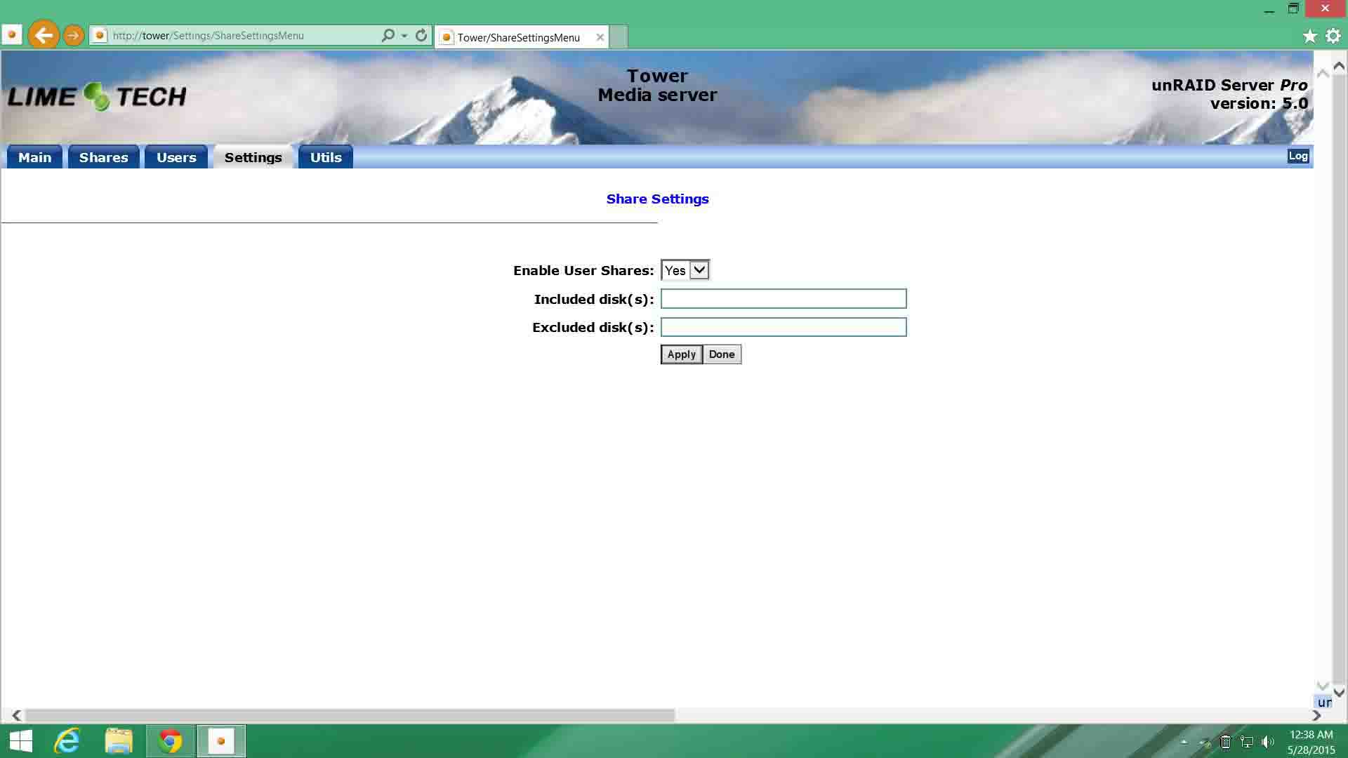

Post a shot of the Web GUI; and of the Global Share settings page
shares

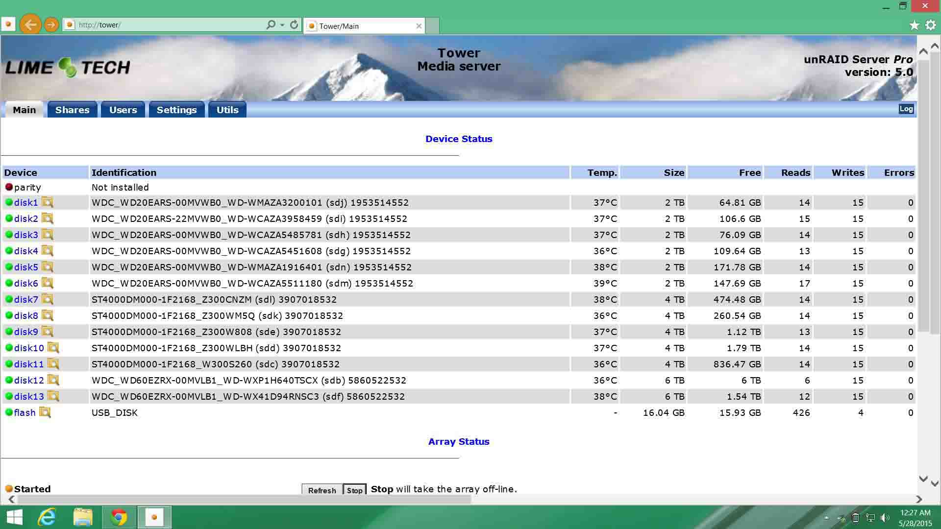

The Web GUI shows 6TB of free space on disk #12 and 1.54TB free on disk #13 ... and shows both as 6TB drives.

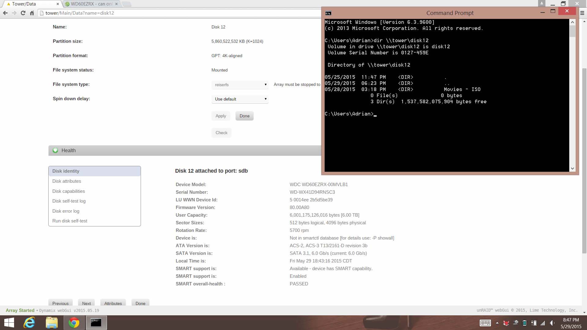

If you open a command prompt in Windows, what does it show for the following ?
dir \\tower\disk13
Show a screenshot of the disk settings for disk 13.

My apologies for my last comment. I was trying to make you aware of what I had done so far.
To recap:
- Completed a clean install to unRAID 6.0rc3
- Prior to enabling share, attempted to write to D13 (which had 4TB+ of data) and could not
- Removed D12 from array (so i can convert it to XFS)
- Moved D13 to D12's old slot (so D12 is now the disk in question - note that both 6TB drives exhibit same behavior)
All drives in array are currently RFS.

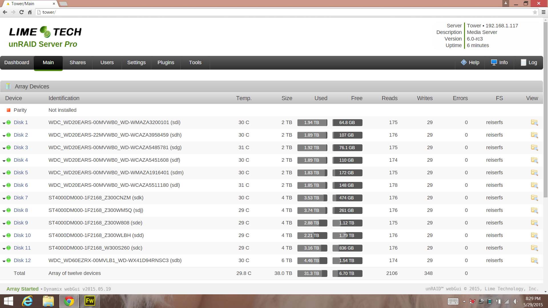

All requested info (updated) is below.
Thank you
syslog.txt
updated main
updated global shares setting

disk12 + Windows reply to dir \\tower\disk12

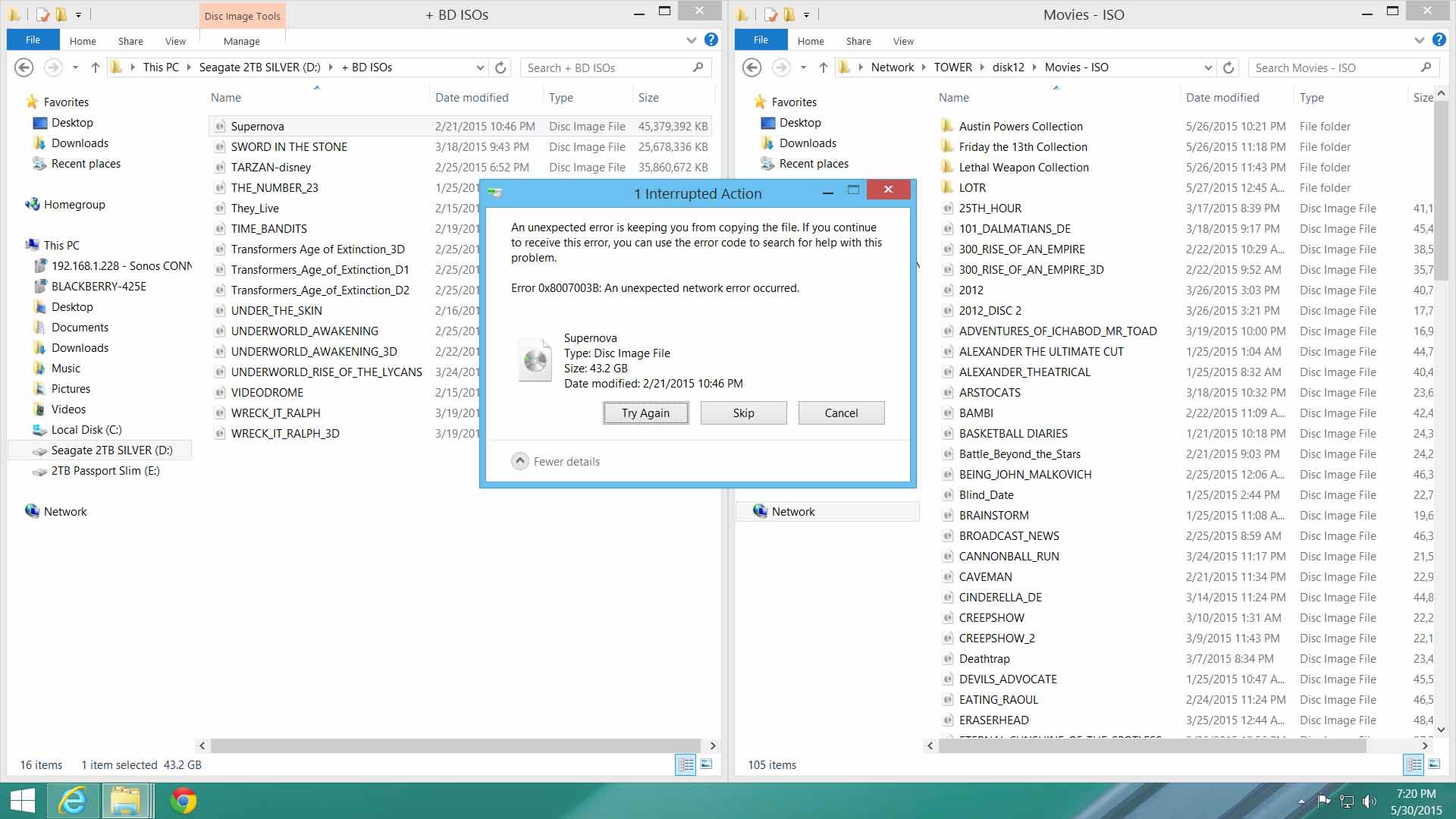

Okay, absolutely all of these imply there's still 1.5TB of free space.
WHAT message do you get when you try to copy more data to the drive?
i.e. show a screenshot of the error(s)
Your writing to disk13 disk share and we have not yet seen the config for the disk13 share. Reply 21 shows the top portion of the disk page. The disk share configuration is shown on the bottom of the page. Please show the disk share config for the drive in question.
Here's the error message
