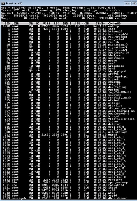

BUT... there is this issue. Browsing from LAN (gigabit as already said...), Dynamix WebGUI on RC3 & 4 - the only I've tested - often becomes unresponsive during page load, mainly between the first two tabs (but it could be a coincidence...), emhttp CPU usage go to 100% (from Top command) and only sometimes I'm able to kill it and restart without a 'segmentation fault' error.
With first two tabs you mean "Dashboard" and "Main" ?
Yes! More... I've just saw that both the pages are created in two ( or more...) updates: first is displayed the main structure with tables and labels, after they are filled with values and icons...  it seems to me that it's during this second phase that emhttp hangs...  :(
Interesting is the 100% CPU usage... Something hangs inside. Is it waiting for... what?

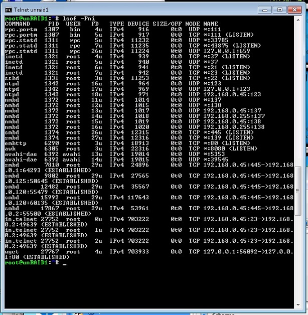

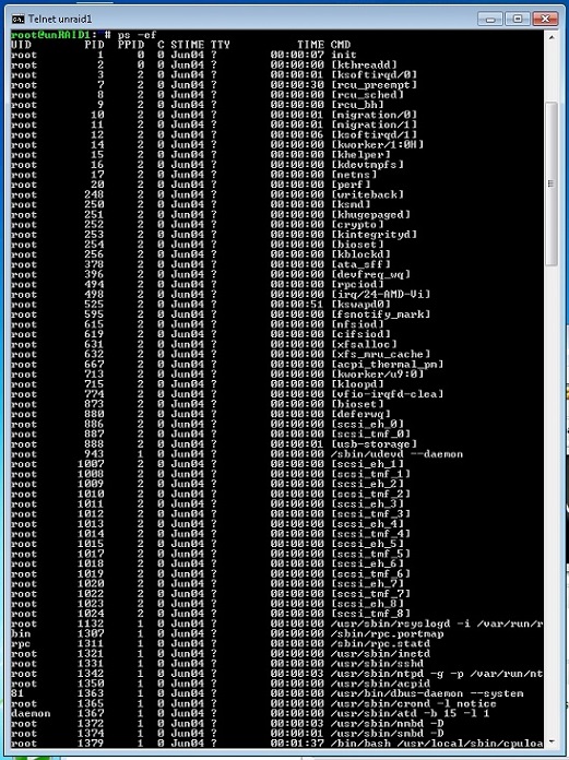

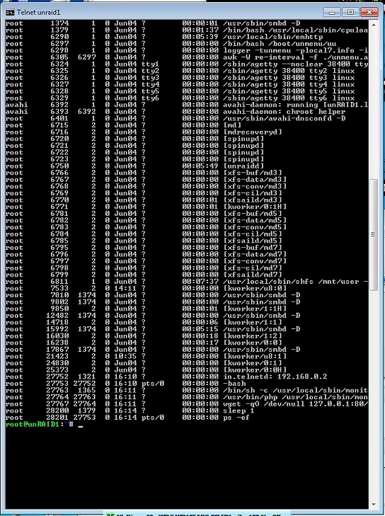

When this happens can you list all running processes: ps -ef
And communication state: lsof -Pni
I've to admit that is very "hard" to make WebGUI to hang by remote BUT... at the end I've succeded in it!  ;D
(at the contrary, locally, on my system, it hangs very frequently...)
After a LOT of fast changing pages on interface, at the end it hanged on loading "Dashboard" page which remained partially loaded, with only Tables & labels loaded and no info/icons in it.
I've attached all you have requested and a top and a Syslog too (taken from unMENU, that, as usually, was ever working...).
After that I was able to reboot server with a reboot command from CLI with no issue.
I've to say that, this level of "usability" is not so bad for me: it doesn't hang if not rarely by remote and I mainly will access it this way, so, for me, it could be even good...  ;)
Two things to note in my opinion:

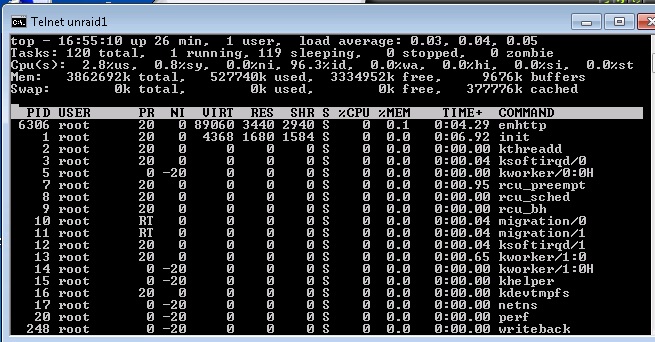

1) Top reports even a high memory usage. It's very strange since server was doing nothing else that following me on browsing WebGUI and I see ever very low memory usage from WebGUI Dashboard (about 15/25% of 4 GB)
2) Only few lines of syslog are related to today. I connected by telnet after WebGUI hanged, and previous lines were only:

This is my top during normal working of WebGUI.
Note how occupated memory is very lower than when emhttp hangs.
I don't know if it is emhttp taking all that memory when it goes to 100% CPU usage anyway...
I saw a very high "cached memory" with WebGUI hanged. Could it be related?  ???
There was no data transfer at all... disk were all spinned down...
I spotted a possible deadlock condition and there's a fix for this next release, might solve this.
