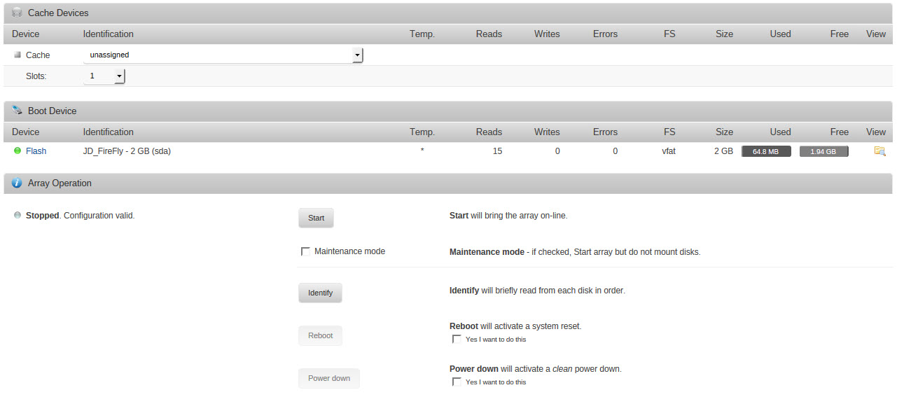

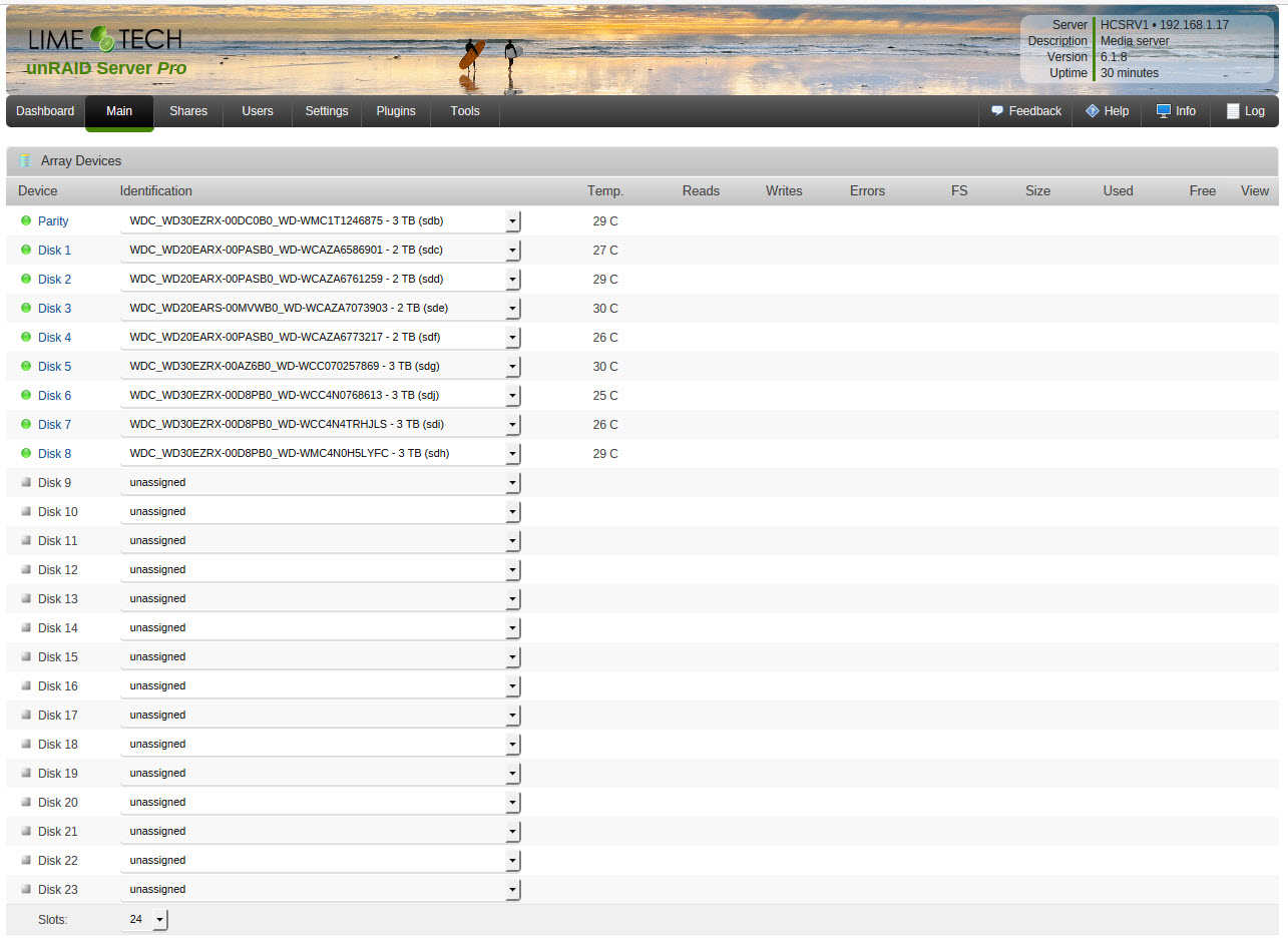

I just realized the transition to version 6
The server started out with the verion 6.1.8
I go to the web page
The discs are well recognized
But the array does not start: I click on Start and it will not start
Where is the problem ?
Thank you for your help
Louis

Go to 'Tools', 'Diagnostics' and post the file with your next post.  Also a screen shot of the 'Main' (array Devices) page could be useful...

No idea from your description.  Have you made sure that you have put your license key file in the config folder on the USB drive?
I would suggest that providing the diagnostics file (Tools->Diagnostics) will help with providing information to get help.  A screen shot of the Main tab showing the Array Devices and the array Operations might also help
Main-1
Louis
Main-2
Louis
Nothing obvious in the syslog - it all looks as one would expect.  I cannot see any sign there, however, of an attempt to start the array.
I notice that the contents of the disk.cfg file in the config folder looks a bit strange.    Did you copy this from the previous install?
The start of mine (before the individual disk details) is:
 Generated settings:
startArray="no"
spindownDelay="3"
queueDepth="1"
spinupGroups="yes"
defaultFormat="2"
defaultFsType="xfs"
poll_attributes="1800"
md_num_stripes="1280"
md_write_limit="768"
md_sync_window="384"
which has a few significant differences to yours.  Not sure if they matter or not.

Did you click on the 'Start' button on the 'Array Operation' Page?  (Under 'Settings', ' Disk Settings', the first option is to 'Enable Auto Start'.  The default is 'No'.  Change it to 'Yes'.)
EDIT:  The 'Enable Auto Start' option is used to automatically start the array when the server is started.  If that option is set to 'No', the array must be manually started from the 'Main', 'Array Operation' tab.
Main-2
Louis
Yes
I enabled "Autostart", then reboot, all is ok
Thank you
Louis
