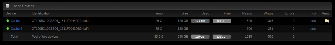

I am running through the same process at the moment and since you're in the middle of this does your cache drive (pool?) appear the same way mine does?  The attached is a screen shot of what the system is reporting through the GUI.
Looks normal to me. Very similar to mine.

Thanks for the clarification, I would have expected the drive labeled as "Cache 2" to show the "Used" and "Free" indicators as well.  I guess the pool reads like a parity drive?  Where as the largest drive would be the only one present?  I installed two 120GB SSDs so if I were to install say another drive that was 256GB the screen would display 256GB as my cache but the total would be 496GB I believe.
It is actually a btrfs raid1 (mirror) rather than parity, though the two can be equivalent in the case of only 2 drives. In some ways the numbers displayed can be confusing and maybe the GUI could be reworked to clear this up a little. Even though you have 240 total, 120 is all you can use because the other 120 is a mirror of the first.
With a 256 added to the 2x120, you would have 240 usable. See here
