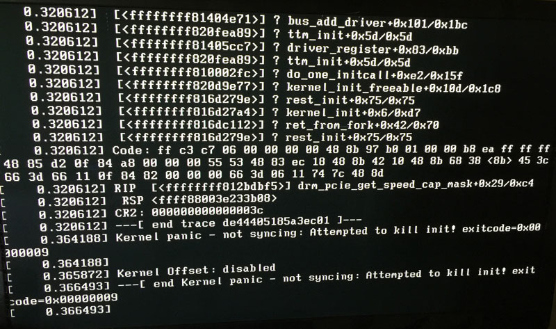

The OpenELEC VM seem to be created properly in the web GUI but it is panicing on startup.  All other VMs continue  to work properly.

Whenever I have this happen to me, it is usually because I am moving a passed-through GPU from one VM to another and I did not shut down one of the VMs properly.  I think it keeps the vid card from resetting.  My only fix has been to reboot the server.
John
Thank your for the response, John. Unfortunately, I'm experiencing the same issue after a server reboot. Are any users successfully using the OpenELEC unVM?
John
For the record, I was able to successfully run the OE unVM (5.95.2).
danofun, have you successfully passed through a GPU to a VM in the past (Windows, Kodi, other)?
John
