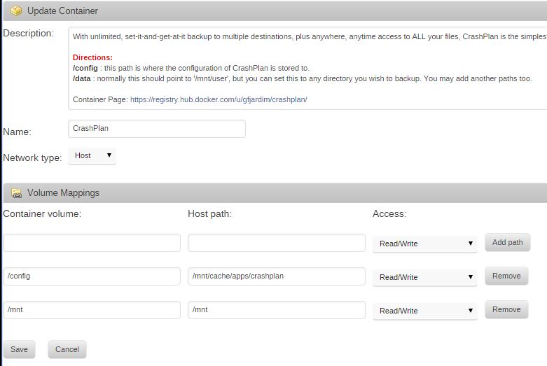

Post your crashplan docker config screen shot.
picture of setup attached.
You need to use /data not /mnt for the docker side unless you edited the config as well.

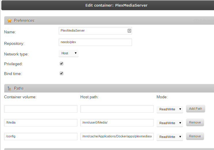

Does this sound like the same issue? Not trying to hijack threads, but I came here with a very similar problem with a brand new Plex install from yesterday. Thanks!

There is nothing in your Host paths that would result in this docker trying to access /mnt/user0/Applications/.plexmediaserver. Are you sure you don't have something else, maybe a Plex plugin still installed?
My config uses /mnt because I was using Crashplan before the docker was created. So when I moved to the docker, I just kept /mnt
I did notice that the first volume was empty.  Not sure how that happened, but I fixed that and am now running again.  Not sure what happens when you have a <blank> mapped to <blank>
