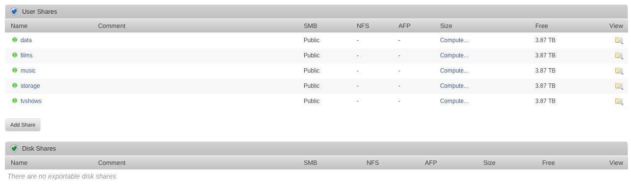

Hello, I used to have my disks available as smb shares.
After upgrading to 6.1-rc5, the disk shares are gone.
I don't remember how I did that in the first place (it was some years ago) :)
Do I have to 'Add Share', call it disk1 and specify disk1 as the only included disk (repeat for each disk) ?
But I wasn't doing that for each new disk I've been adding and yet, they showed up as smb shares.
Attached is a pic of my current shares
Please read the announcement of v6.1rc1 here
