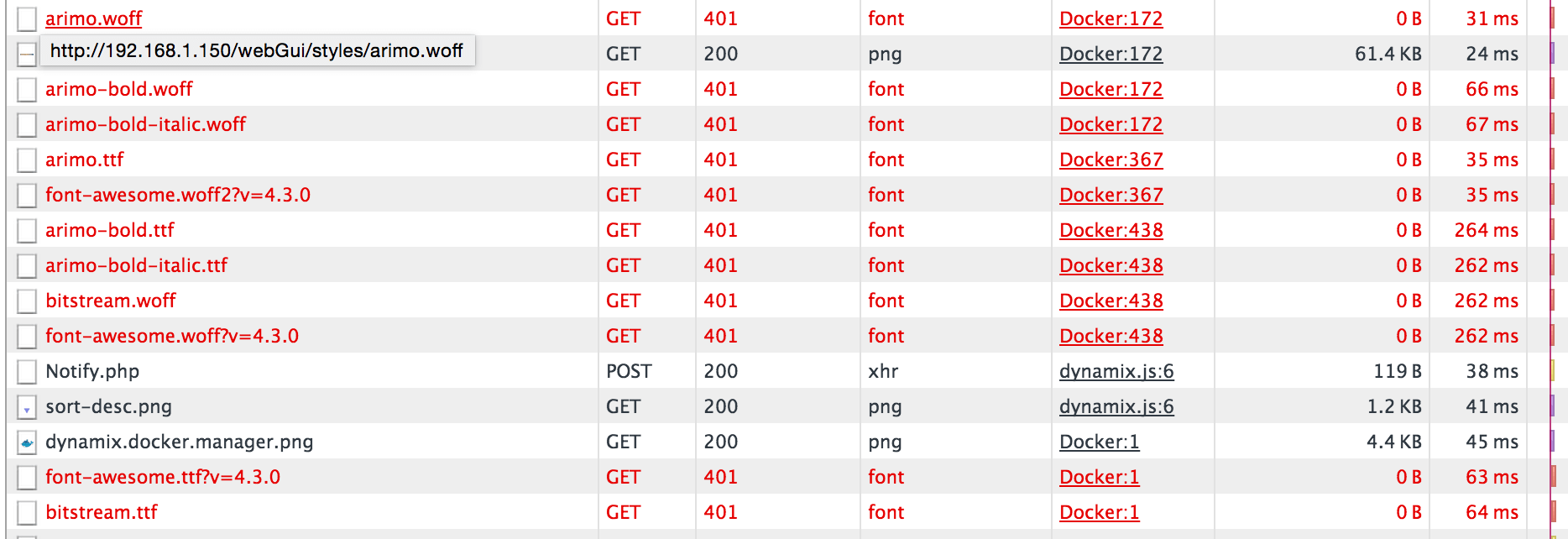

Ever since I upgraded to RC3, Chrome has been unable to retrieve any of the webfonts. It keeps getting 401 Not authorized responses. Navigating directly to the URL works. I experience no problems in Safari or Firefox.

First I recommend you upgrade to v6.1rc5, but this has nothing to do with your issue.
It seems the style-sheet files (.css) are not loaded. Are they deleted?
You can check manually by telnetting into your system:
# ls -l /usr/local/emhttp/webGui/styles/*.css

Sorry, I meant to say I did upgrade to RC5 but had this issue since RC3.
The stylesheets are there and it works fine in Firefox and Safari. Only happens in Chrome when the urls are loading from the webGui. Navigating directly to the urls works. From inspecting with the Chrome dev tools it looks like Chrome is not adding the authorization header.

Weird, I am using Chrome (44.0.2403.155) too and don't have issues.
I'm having no issues with Chrome on my Windows 10 laptop, Windows 8.1 desktop, my Android tablet and Android phone.  Be interesting to see what the issue is.
Does this cause the fonts on the webgui to be rendered in times new roman or something?  Have you tried clearing browser cache?
