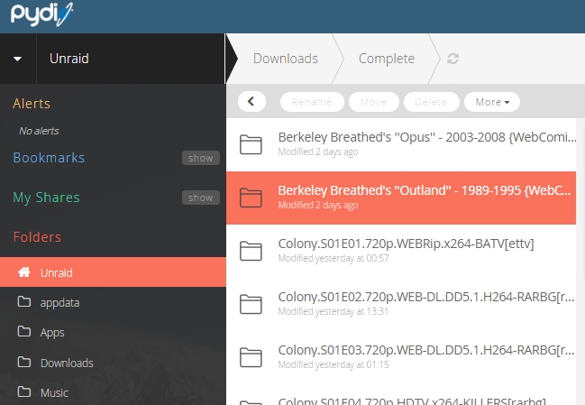

Permissions issue?
Pydio has been up and running fine for a while, i can access all my files. However, from the beginning i noticed an issue with folders created by other dockers (specifically, Transmission):
Folders i create in the unraid array (either by using MC on the server, or by accessing shares from my local network) can be manipulated with the Pydio gui (rename, move, delete etc).
Folders and files created by Transmission when downloading torrents i cannot do anything with, the options are grayed out.
I assume it's a permissions issue, but i don't know enough about linux to really check. any suggestions?
