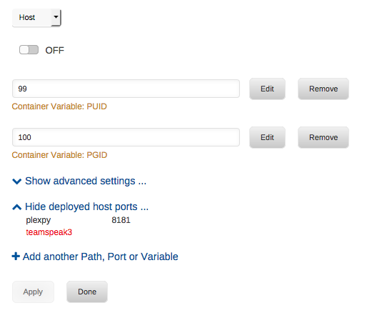

OK, I'm new to Teamspeak, but not new to Dockers or UNRAID.  Just trying to set up a Teamspeak server for my son.
Anyhow.. I've attached my config screen.  Under deployed ports, it shows PLEXPY which is another container I have installed and working fine.  But the TEAMSPEAK shows up in RED.  I'm assuming that's a bad thing.  Do I need to define the ports? and if so which are the common ports to use for TEAMSPEAK?
Thanks
Mike
You can only assign one application per port, if I were you I'd stop the plexpy container and then edit it and change 8181 on the host side to something else and then use TS3 on all the default ports.

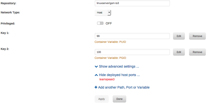

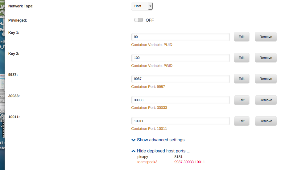

Here's what my config screen looks like now after some tinkering..
The reason the TEAMSPEAK one is red, is that it's the current config I'm looking at.. when i look at Plexpy's config, it shows as read, and teamspeak is black, so I think that's ok.

It looks like you changed the container port along with the host port (hard to tell because maybe you only changed the name).  The app still needs to communicate on (what it thinks is 8181).  Always leave container ports alone and only change the host port.  Then the outside world communicates with the app via the host port, but as far as the app is concerned is still talking on 8181

What my configuration looks like.
Thoughts?

It works fine in both host mode and bridged mode.  If you want bridged mode forward these ports:
UDP 9987
TCP 10011
TCP 30033
TCP 41114

Those files exist in the docker logs directory and have the read attribute set.
Thoughts?

Your port settings look fine.  If it still doesn't work something might be wrong with the docker and your specific version of unRAID.  What version are you running (looks like 6.0 or 6.1)?  I'm using 6.2,
