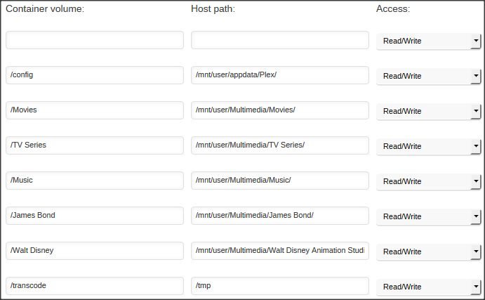

There are many ways to setup your library but here is a common one:
Make a user User Share called Media on your array and setup what disks that should be included.
Then you make sub folders for Movies, Music, TV Shows and Photos (using  Windows file explorer if you use Windows).

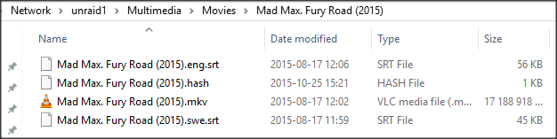

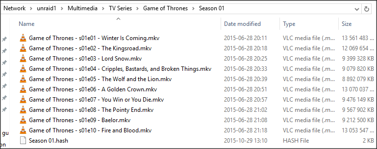

For each of these folders you need additional sub folders, in Movies one folder for each movie, in Music one folder for each album, in TV Series one folder for each TV series and then one additional sub folder for each season.
You need to have folder mapping in Docker to match the location of the Movies, Music, TV Shows and Photos folders. You also need to setup each library in Plex to point to these locations. You will need to browse to the folder setup in the Docker mappings for each library to add it to Plex.
Make sure to check the Plex support page so that you name your media files correctly.
You can also do a different setup (like myself as you can see on the pics) with other library’s than the predefined ones.
If your media already is on your unRAID server, you might be able to include it where it is now. If it is on your unRAID server but you would like to move it around I mostly use Windows file explorer. A more efficient way to do it is from the command prompt in unRAID is with MC (Midnight Commander) since files will be copied directly between User Shares instead of over the network.
I am still having trouble with the folder mapping. My User share is \\Tower\Storage1\ and it has a subfolder called "MyMovies" with all my movies. I tried to map the Container volume as \Movies and the Host path: as \\Tower\Storage1\MyMovies but, everything seemed to crap out and Plex was no longer listed with the Dockers. I guess I need to re-install the Plex Docker.
You are trying to reference it by the computer name.  You should be using the local paths which I this case is /mnt/user/Storage1/MyMovies and your container path would be /movies
I hope this is on topic, but why do the movies each need their own folder? I am not running my unread server yet, but I am running PMS accessing an external USB3 drive on my Mac. My TV shows all get separate folders, as does each season in that folder, but I have all my movies in one folder and Plex seems to operate fine.
Thank you,
Michael
It is good practice to put each movie in its own folder. This started back when a movie would be split into multiple file , ie movie.cd1.avi, movie.cd2.avi . Now we do this mainly because of extra data that might accompany the video file. For example subtitles, nfo files, poster metadata etc. Plex can identify all movies put together in a folder, but it is still better to do it the other way.
