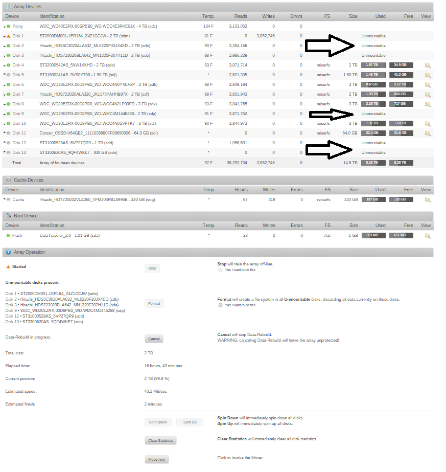

Well after an upgrade Hell :-[ - I am rebuiding data with the NEW MB/CPU,RAM on disk 1 per no matter what i tried cables - different ports etc i finally switched out drive 1 with another and again its almost done rebuilding the data on it, Ok now for my bigger issue i still have 5 yes...... 5 Drives that show UNMOUNTABLE.
See the picture of whats happening from the webui , the unmountable drives show green but it's like their file system is not there!
I have and will not format (I will loose my data on those drives) or even check parity until i hear from an expert on the next steps.
I have stopped my docker - Plex and also turned it off from auto starting...  Please help i am really frustrated and I have searched the site and there seems to be articles on this subject but i am skeptical on which path to take....

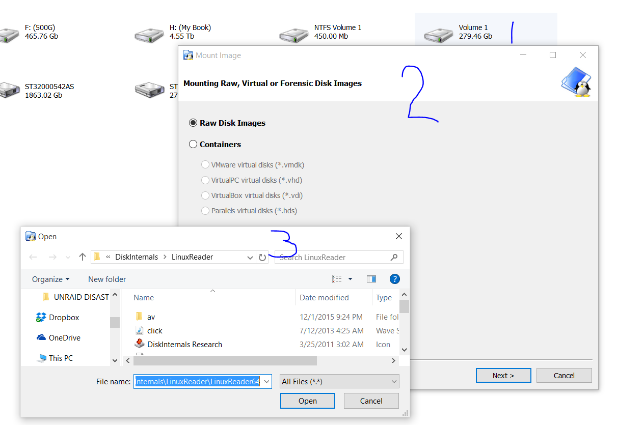

  I am right there with you :D i took the smallest unmountable drive a 300gb and hooked it up to my win 10 pc and it made my pc hang on boot, another issue ...  ok so remembering an old trick i downloaded knoppix live DVD burned it and booted the win 10 machine and that didnt work out per i am not to familar with knoppix and it was in German :o and couldnt get it switched over to english....  I still have the drive hooked up and windows 10 - doesnt even see it from disk management, so not sure if the free linux reader will see the drive?
  Installing Linux reader now! will advise...
If connecting the drive to a SATA port is causing boot issues, try using a USB bridge device (assuming you have one) ... you can then plug it in after the system is booted.
its booted now and disk management sees it but my computer doesn't show it, probably per theres no assigned number or name, ok got linux reader installed and it shows the 300g drive but i get errors trying just to open it - so i tried to mount it and its looking for something i am not sure? see the pix... i guess i better read up..

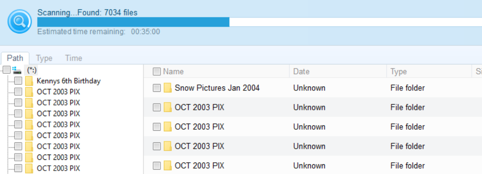

BTW, when I see files you're recovering titled "Kennys 6th Birthday" and a lot of pictures from years ago, I find it amazing that you didn't at least backup your family memories !!    I hope you are able to recover all of these -- and that you learn the lesson about backing up data you don't want to lose.
I understand and advice taken on the prevoius post and will run a memtest for tonight etc ....  Yes i do have all the pictures backup i just remembered on dropbox and another external drive outside the array....  ;D
