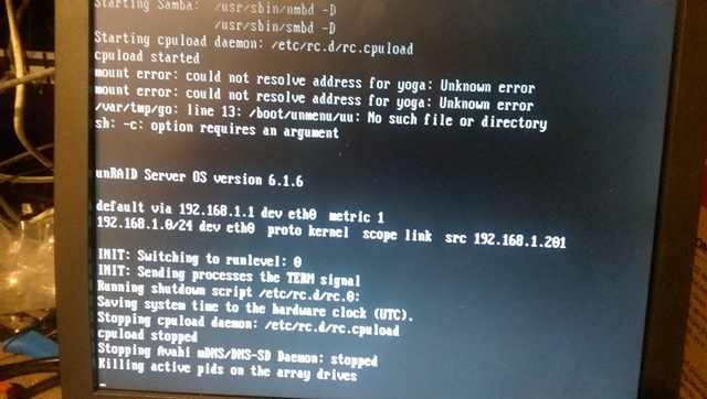

Went physically down to the server, and plugged in a monitor.  There was nothing specific that looked alarming.  (It was all normal - I expect that it can't mount the machine names yoga, as it's a laptop and wasn't powered on...)
I then pushed the reboot button on the server, to allow the shutdown script to run.
It hung on the "killing PIDs" step that you see below.  I gave it several minutes to respond, and it did not.

In your screenshot there are already errors reported during start up of the system.
A mount to a unknown device is attempted and it tries to start unmenu which seemingly is not present.
Your go file needs some cleanup, or alternatively start with a 'virgin' go file.
Will do.  Is there a specific line from the go file to eliminate unmenu?
