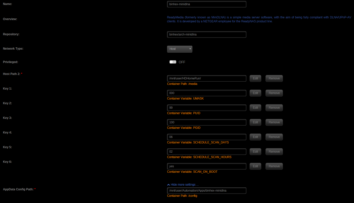

You need to install and use binhex-minidlna.  You will then see the Linux icon, select that, login, and save.  Assuming you have your directory path set correctly, should work.  Of course you also need to setup a share.  To help you with the minidnla settings, see mine below.
Just use the docker.  No need to do the nas install.
I used the minidnla docker as well as the hdhomerun docker, and it works as expected.  You still have to link the the two together to record shows.

Thanks a ton, now I can give the DVR service a try!

I installed the miniDLNA docker to try and "work around" whatever issue is happening.  I set up my docker from the screenshot that @Switchblade provided, pointing it to my HDHomeRun directory and share on my Array.  Hit apply, no errors, but after that... I've got nothing.
