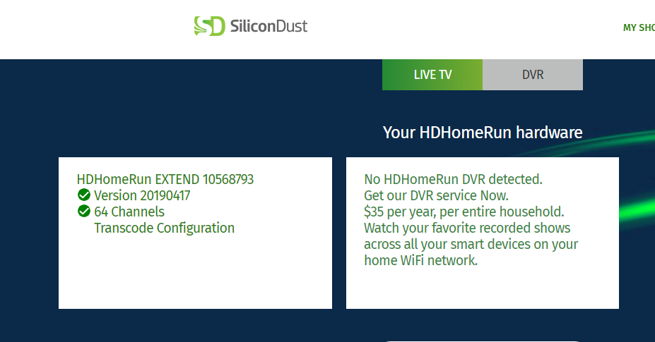

@Switchblade I'm traveling for work right now so can't post up screenshots. But the thing you can an "advertisement" for the DVR service is there because Silicon Dust can't detect your DVR due to the change in the docker. If it was detected, you'd have the version number listed of your DVR. I've emailed S.D. about the issue and they aren't able to detect my DVR service/subscription due to the change in the docker.
I think if you were to delete a recording rule and/or try to record something you're watching live TV , you'll notice the record bottom is missing off the GUI of the official HDHomerun App.
And the user "Italy#####" also mentioned he is having an issue and had to roll back his docker.  So I'm not the only user with the problem. I tend to think you also have an issue but just don't realize it....?

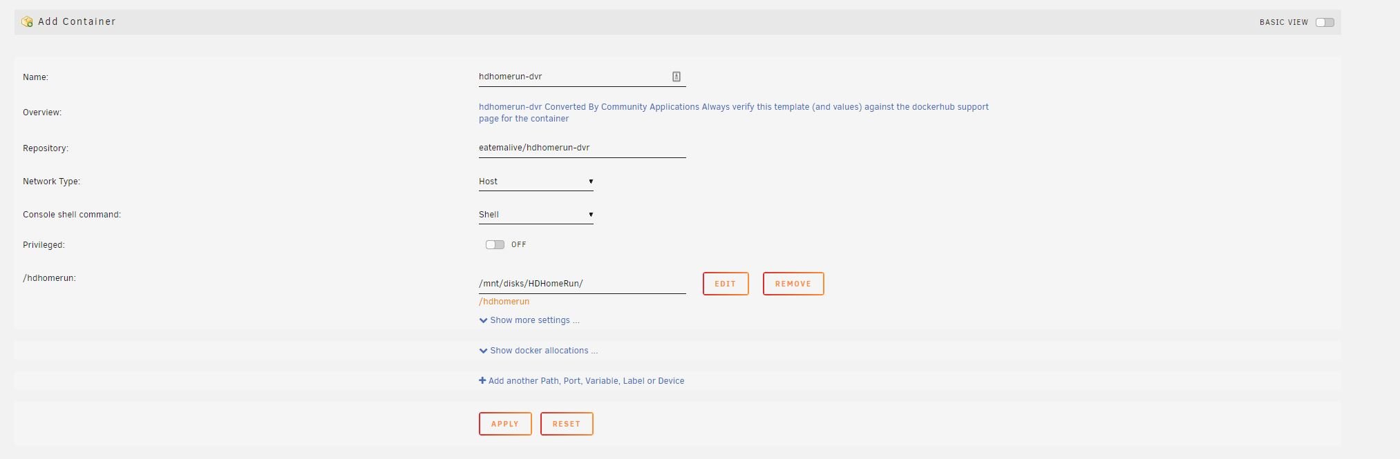

my setup looks like this:
Edited by eatemalive
That worked.. had to remove ":latest". Thanks
