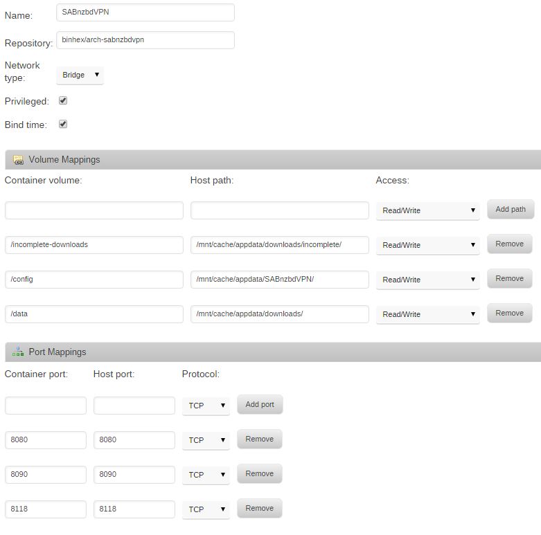

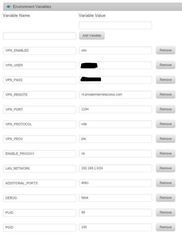

hmm ok screenshots is all we have then, can you please left click the icon, select edit and then toggle the advanced view option on then take a screenshot (you might want to temporarily remove username and password from the vpn section).
Ok, before I do that, I noticed a configuration difference between your SABnzbd docker and linuxserver.io's.  The Privileged checkbox in the advanced view was ticked with the default settings.  If I uncheck this box then the docker starts.  I need to configure all of my variables to see if the gui will start but is this an issue if it solves my problem?
you will need to have the privileged checkbox ticked for this docker to run, it creates a vpn tunnel adapter which wont happen unless you have that checked, there are a LOT of differences between this one and the linux io one, as this includes a vpn which needs to be configured (see advanced settings).
Ok, the only way I could get the docker to start was to load your default and uncheck Privileged.  Once I updated directories, and ENV variable information, the docker would no longer start with the attached settings.

ok two things, firstly are you sure the defined LAN_NETWORK is correct?, as in is your lan network 192.168.1.x ?, secondly check the permissions on the unraid side for /config and /data, your using user nobody group users (99 and 100), which is the standard permissions for unraid, if you have it set to something else then you will need to change the PUID and PGID values.
oh and lastly, make sure you have ALL sabnzbd docker containers stopped, otherwise you will get a port clash

can you double check you def do not have anything else running on port 8080 or 8090 (not running unmenu are you?)
one last question, and im hoping this isnt the issue, what version of unraid are you running?.
Ok, I started troubleshooting using your basic template.  On first install, docker won't run. If I uncheck Privileged then it runs. If I add my /config and /data folders (with Privileged unchecked) it again won't run.  All other variables are left as-is with your default template.  I deleted my /config directory and the docker appears to recreate it without issue (although it's empty).  My /data directory is used by several other dockers so I can't see it being an issue but I could be wrong.
I'm using UnRAID 6.1.9.  I did have linuxserver.io's SABnzbd docker running on those ports but I've since deleted that docker and rebooted the server prior to posting my issue today.  No unmenu running.
ok im stumped for now, i will have to rack my brain for any ideas, just to double check i did a clean install here and it started with no issues  :o

If anybody is seeing issues please screenshot your edit screen with advanced view switched on, also post the supervisord.log file (located in /config).
