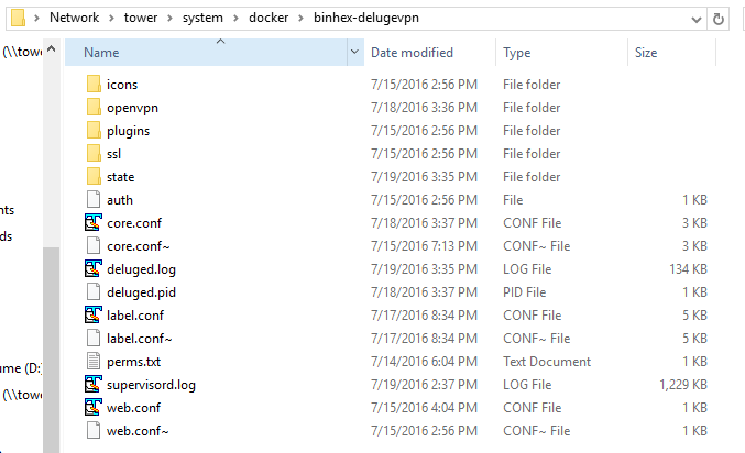

Ok, I've successfully got strong encryption running on your DelugeVPN docker but I still can't get this docker to start.  One thing I noticed is that nothing is written to the /config folder (in my case, /mnt/cache/appdata/SABnzbdVPN/).  The directory is however created successfully when pull down the image.  Here's the folder permissions of my /mnt/cache/appdata directory:
drwxrwxr-x  4 nobody users 113 Jul 19 10:11 SABnzbd/
drwxrwxrwx  2 nobody users   6 Jul 19 11:33 SABnzbdVPN/
drwxrwxrwx  7 nobody users 256 Jul 19 10:58 delugeVPN/
drwxrwxr-x  3 nobody users  24 Jul 19 11:19 downloads/
drwxrwxrwx 13 nobody users 168 Jun  2 13:29 emby/
drwxrwxrwx  7 nobody users 232 Jul 19 13:04 sonarr/
All other dockers are working correctly and the non-VPN verison of your SABnzbd docker is also working correctly?!  Still stumped...just thought I'd check back on whether there's any other info I can provide?  No SABnzbdVPN log is generated since no files are being written to the /config directory and the UnRAID log is useless.

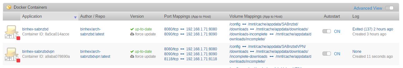

Hmmm...can't find it. I tried both views. The log link is for syslog and the other logs are docker dependent with this one being blank?!  Maybe a screenshot?
Not the application log, but the docker log.
Available at the docker tab in the unraid webgui (you may need to click advanced view)
First one in on regular view, second one is advanced view.
In advanced view you can see then the log did get created, how long is has been for the last change/edit.
Just click there I have marked with red.
width=250https://i.imgur.com/Jjf3oPX.jpg[/img]
width=250https://i.imgur.com/HrSJRXz.jpg[/img]

We were talking about the same thing.  Mine says "none" which makes sense because my /config directory where the log is stored is completely empty.
here is my folder and its contents
Myk
Myk
Which is exactly how the non-VPN SABnzbd folder looks (of course minus the VPN stuff).  Where can I tell if the docker installed correctly or not?  The syslog is not helpful and per my pic, the docker shows installed but stopped on my docker page.  When I try to start it, nothing happens.  I stopped the other SABnzbd docker (binhex version as well and works perfectly) to avoid a port conflict.

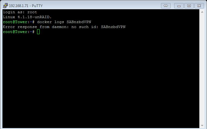

ok can you please ssh into unraid and run this command, it should give us a clue as to what is going on:-
docker logs <name of your sabnzbd container>
please paste the output here
i know youve stated above that the logs dont contain anything useful, but the above command should give us something.

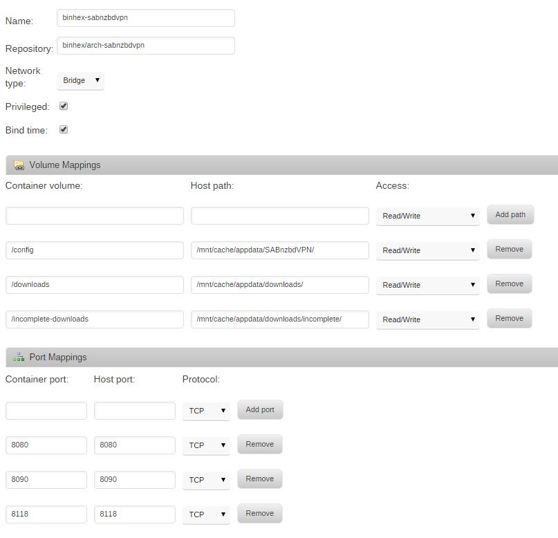

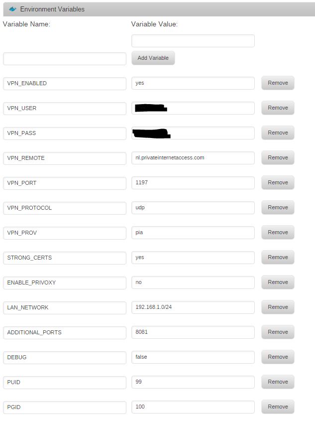

also if you can screenshot your settings for the container, make sure to select the advanced view option so we can see all defined values, obviously hiding your username and password.
Myk
It's  pretty much the same as before:
http://lime-technology.com/forum/index.php?topic=45822.msg482984#msg482984
Except now I get the notification there's no such container.  If you review the pic I posted above, you can see the container is installed but not running.  Log output works for SABnzbd and DelugeVPN (both are your dockers).  See attached.

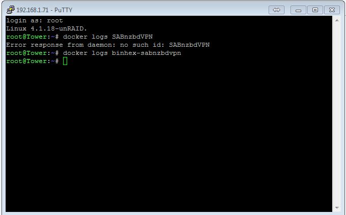

wrong name, your container is called "binhex-sabnzbdvpn"
LOL...sorry.  I forgot I left the default name to reduce variables.  Now it is the exact same output.

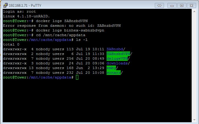

ok now that is really wierd, so the container looks to do a big fat nothing, hmmm, ok cane you delete the container AND the image, then use the my templates again to select the config details you had earlier to repull it down.
one quick question, are you running anything on port 8080 or 8090 on your unraid host?, unmenu for instance?.
I did that exact procedure the last 3 times (hence the change to the docker name).  It's as if the docker isn't really installing because the /config directory never populates with any files.
The only thing running on ports 8080 and 8090 is SABnzbd.  I completely removed the non-VPN version to avoid any possible conflict but the same result.  The only think I haven't tried is blowing away my image file completely and reinstalling all dockers.  I was thinking of upgrading to 6.2 RC2 if I go that far though.

Attached is the output of my /mnt/cache/appdata/ directory.  I used the dropdowns in the docker config to avoid any typos.
