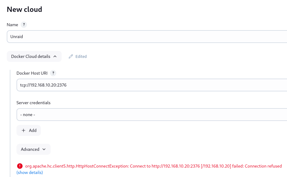

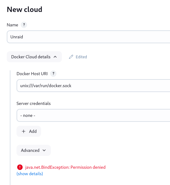

@binhex I can't figure out how to get this to work with docker on the Unraid host. I've tried both the `/var/run/docker.sock` and by ip `192.168.10.20:2376`. Both methods seem to encounter permission issues.
First I passed through `/var/run/docker.sock` to the container by adding it as a path. If I try to add a docker cloud as `unix:///var/run/docker.sock` I get permission denied
So, I tried the other method based on previous replies in this thread. First I modified the `/boot/config/docker.cfg` file and added `DOCKER_OPS="-H unix:///var/run/docker.sock -H tcp://0.0.0.0:2376"`. I then rebooted Unraid so it would start docker with this options. I then changed the setting to `tcp://192.168.10.20:2376` and get a connection refused.
I am stumped on how to get this to work. I want Jenkins to build container images. Without it being connected to docker I don't think it can do that and it makes it useless to me...
