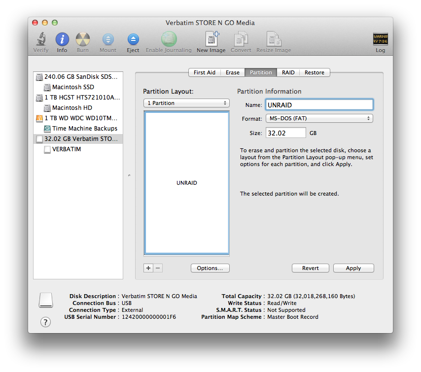

I don't understand why you had to reformat your USB flash device. How big is it and why was is originally less than 512 MB? Are you trying to partition it for some reason? Don't do that. Use the whole thing. Small ones are difficult to find these days. I use an 8 GB one and it has plenty of free space, but a 2 GB one would be fine. The largest size you can use is 32 GB, I seem to recall.
I have a MacBook Pro and found it difficult to format the 16GB thumb drive as my boot device. It would not boot from the USB until I was able to format it on a Windows which I run in Desktop Parallels. When I initially was able to format it in the Windows OS the maximum size it would allow for some reason was 200MB. After just upgrading to unRAID 6.1.7 I saw that 200MB was not going to cut it and looked in the manual. That is when I saw the 512MB minimum and why I reformatted my boot device. I am not sure if it was the cause of any problems, but I have not experienced the machine name change since I have done that. It would previously after a reboot revert back to Tower and cause conflict between machines reconnecting like TimeMachine for example. Now after the past few reboots it remains NAS and no longer reverts back to Tower.
I'm using a MacBook Pro right now. I use Disk Utility (included with OS X) to format my USB flash devices. To be safe I use the Partition option, set the Partition layout to 1 Partition in the drop down menu, check that the Partition Map Scheme is set to Master Boot Record (change it if necessary with the Options... button), set the Name to UNRAID and the format to MS-DOS (FAT), then click Apply. Then I download the unRAID installer, unzip it by double clicking it. Then I copy all the files from the unzipped folder onto the flash and, finally, run the make_bootable_mac utility in the root before Ejecting and removing the device. No need for Bootcamp or Parallels. May I suggest you create yourself a good boot flash before trying to proceed.
Your flash currently has two partitions, the second of which is invalid.

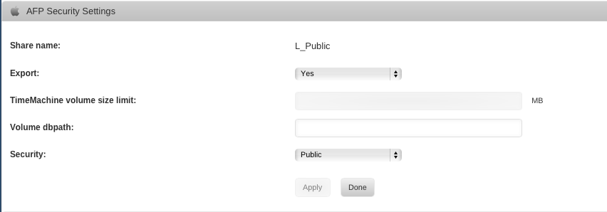

Try re-enabling the Ethernet channel bonding, once you've fixed the above, if you want to. You might need to enable the bridge too in order to make it work (turn the Dynamix help on for more information) and note that Active-backup (mode 1) is the only channel bonding mode you can use with a regular unmanaged switch and note that you won't see any increased throughput between the server and a single client though it would benefit the case of multiple simultaneous clients and, of course, it will provide a degree of redundancy, though you might well see an increase in dropped packets.
In fact your B-----s.cfg file in the shares folder of your most recent diagnostics has an AFP volume size limit applied, which makes me think it's intended for Time Machine backups. So it looks as though that's where Time Machine should be pointing, not to B..t.
