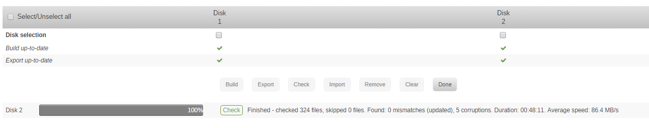

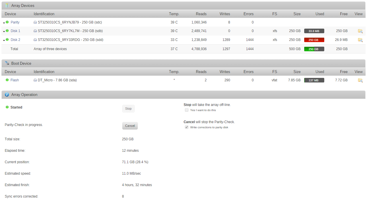

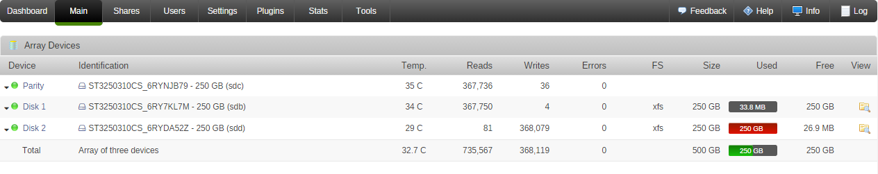

These screens are from the test I made:
1 - having just run a parity check with 0 errors, made the disk fail during a correcting parity check, after it found some errors aborted check.
2 – rebuild to new disk
3 – checksum found 5 corrupted files (would probably find many more If I hadn’t stop the parity check).
