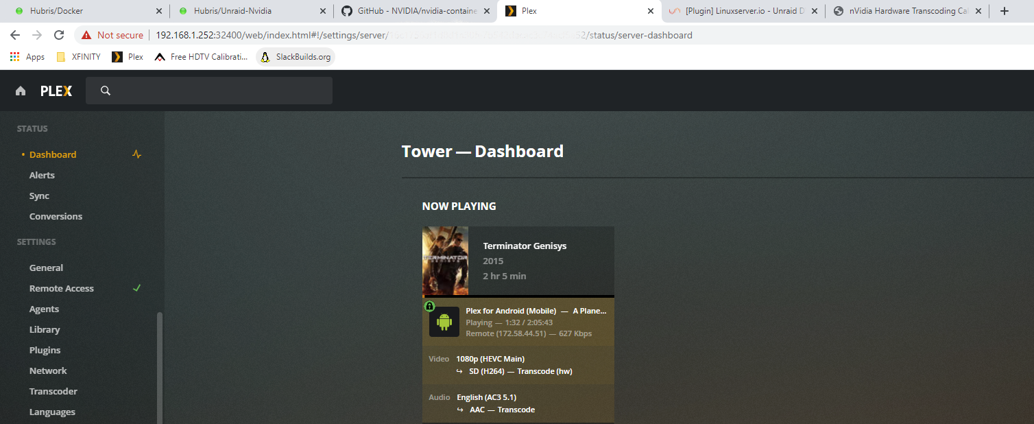

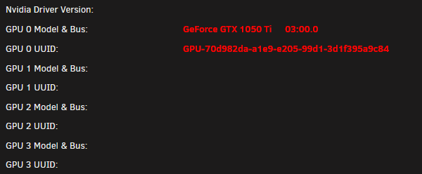

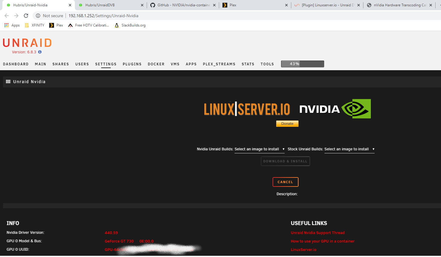

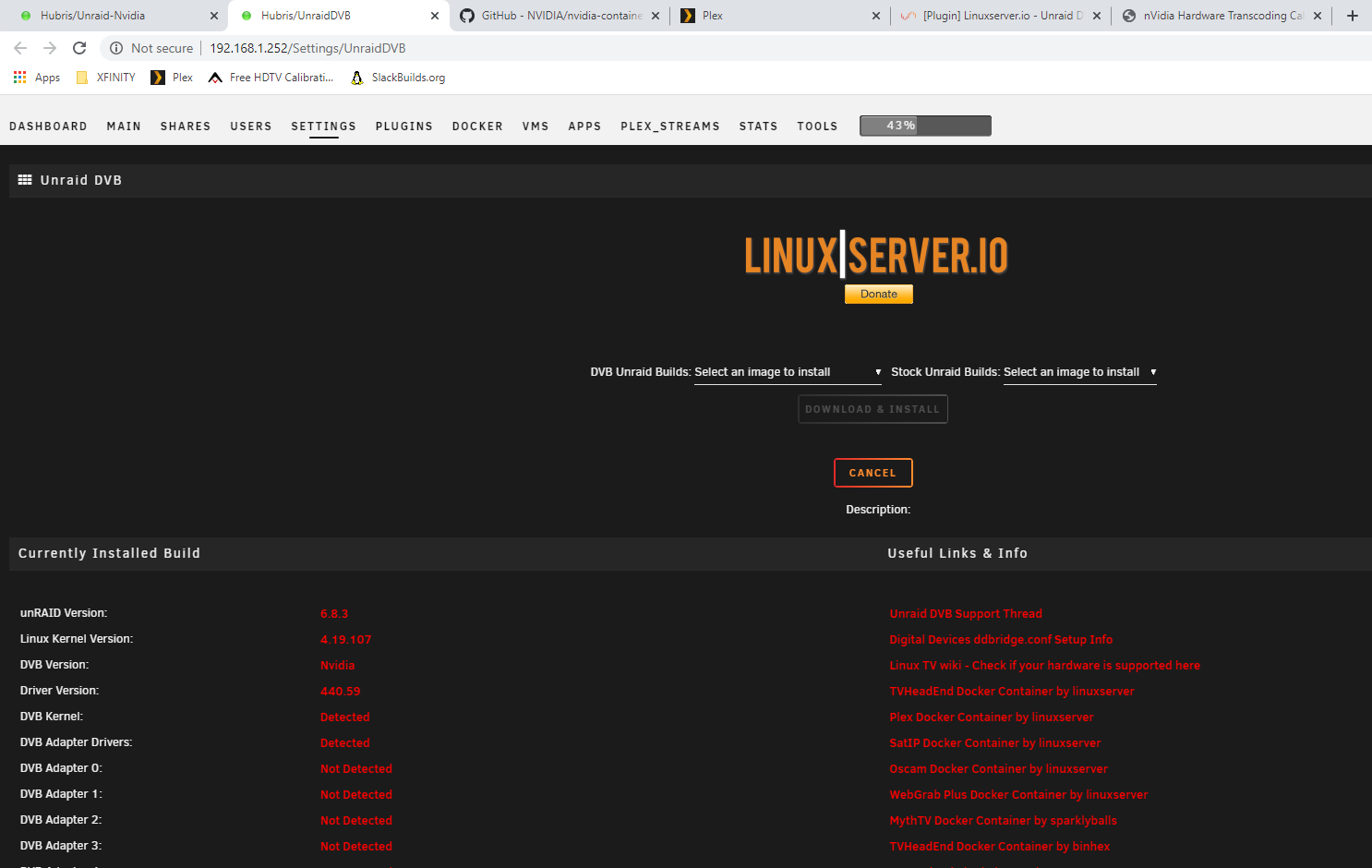

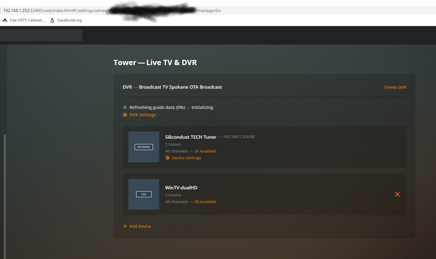

So, starting with the NVIDIA build for 6.8.3 AND the DVB Build for 6.8.3 I was able to smush the DVB drivers into the NVIDIA Build, I had to modprobe the specific driver (em28xx) for my Hauppage WinTV-Dual-USB as I didn't manage to get it to auto-load  but it works, SEE!:
my only problem is that my DVB adapter, a hauppage WINTV-Dual-USB do not show up in the UNRAID DVB plugin but plex does detect and stream from it just as well as it did previously.
Now I would like to point out that there is no polish on this setup,  I have to manually modprobe the driver after boot time at this point, before I start my plex docker (thank you LSIO for the docker, that was the last thing that I needed to make this thing work, the official plex docker wouldn't do the HW transcode) and that, after testing this issue it does not go away on a reboot.

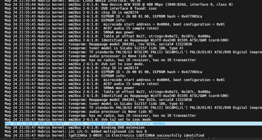

Here is how I did it, bask in the simple power of duct-tape based jank:
  1. I first downloaded both NVIDIA and DVB plugins.
  2. Then I selected the LibreElec 6.8.3 (because that is what works with my tuner) build in the DVB plugin and installed it
  3. Reboot the server
  4. I then confirmed that my DVB device was showing in the DVB plugin
  5. Sifting through the syslog (check my snip it helps to show what I mean) I wrote down the dvb driver that my device was being assigned to (the snip is from after the combination but it is identical to the way that it would be from the before combination)
  6. Then I copied the bzfirmware and bzmodules files from my flash share
  7. I then installed the NVIDIA 6.8.3 build in the NVIDIA plugin
  8. Reboot the server
  9. I confirmed that my Graphics card was showing in the NVIDIA plugin
  10. I copied the bzfirmware and bzmodules files from my flash share (yes, i did this twice, once for the DVB setup and once for the Nvidia setup)
  11. I then unpacked both of them in windows into separate folders (you could do this in whatever you want but i like the simplicity of the windows GUI)
  12. I then copied the contents of the DVB bzfirmware into the NVIDIA bzfirmware folder chosing NOT to overwrite any existing files
  13. I then copied the contents of the DVB bzmodules \4.19.107-Unraid\kernel\drivers\media to the same folder in the NVIDIA bzmodules folder
  14. I then shared both folders to a linux VM I spun up for this and used mksquashfs to zip them both back up (make sure to use the -all-root option to avoid contaminating the permissions of the output bzfirmware and bzmodules files)
  15. I then copied the two brand new bz files on top of the ones in my flash drive
  16. After a final reboot (and some related troubleshooting that led me to migrate my plex container to the LSIO version) all I have to do is modprobe my driver back in after boot EVERY SINGLE TIME! and start my plex container
My next task will be to setup a user script that runs on array start to modprobe that driver so I don't have to do it by hand but it is almost midnight here and I have to work in the morning.
Edited by mkfelidae
better formatting
How did you utilize the DVB card?
With my build of the nVidia and DVB drivers my DigitalDevices Card only shows up if I start TVHeadend (the kernel modules is loaded if the card is needed) and TVHeadend requires direct access to the path '/dev/dvb'.
I have a script that calls:
     modprobe em28xx
When the array is started.  Then I have my Plex docker setup for an autostart delay of 30 seconds, to give the script time to fire and for modprobe to load not only em28xx but all of its dependencies such as the dvb_core driver.
For me, /dev/dvb, isn't an actual path until the modprobe script fires.  That is the real reason my Plex docker has an autostart delay, the docker crashes on start if the drivers haven't been loaded and /dev/dvb hasn't been created.
When I said that my USB stick doesn't show up in the dvb plugin, I meant it ONLY doesn't show up in the adapters list on the plugin GUI.  If I had to take a guess why, it would be that the GUI is looking for the devices at boot time, but that the device doesn't show as a dvb device until I load the driver at array start.
I hope this helps, if not let me know.

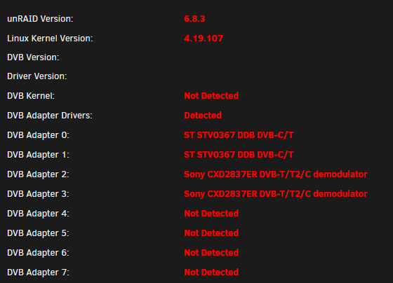

Currently the DVB plugin from linuxserver.io looks like this:
and the nVidia plugin linuxserver.io looks like this with the build from my container:
But everything is working just fine.
