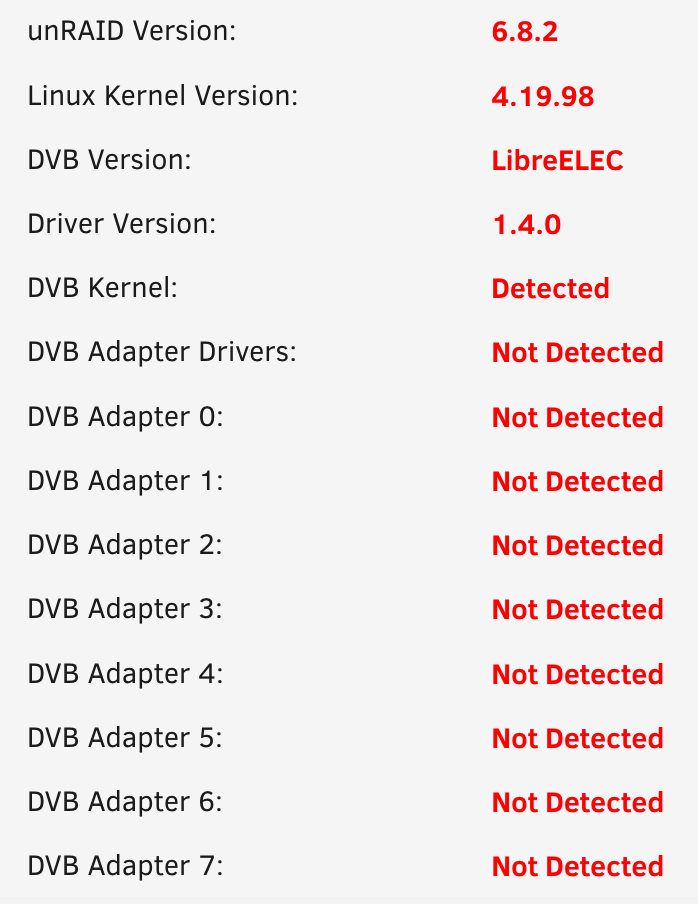

Hello, I have been at this for many hours today and hoping I have simply overlooked something very simple.
I have installed a DBSky S952 (2.2a) PCIe card, followed by installing this Plugin.
On the notion that it is not TBS I started with the LibreELEC latest release, nothing detected.
I have rolled back through the versions to 6.7.2, nothing detected (rebooting as instructed after each installation).
Tried the latest releases of TBS on the off-chance, nothing detected.
In my Hardware Profile I can see the PCI card is recognised here:
Using 'lspci' command I can see:
09:00.0 Multimedia video controller: Conexant Systems, Inc. CX23885 PCI Video and Audio Decoder (rev 04)
Using 'lspci -v' to get more information the following is present:
        Subsystem: DVBSky S952
        Flags: bus master, fast devsel, latency 0, IRQ 35
        Memory at fcc00000 (64-bit, non-prefetchable)
        Capabilities: [40] Express Endpoint, MSI 00
        Capabilities: [80] Power Management version 2
        Capabilities: [90] Vital Product Data
        Capabilities: [a0] MSI: Enable- Count=1/1 Maskable- 64bit+
        Capabilities: [100] Advanced Error Reporting
        Capabilities: [200] Virtual Channel
        Kernel driver in use: cx23885
        Kernel modules: cx23885
So, it seems like the OS can detect the hardware is present.
One of the issues I seem to have found is that '/dev/dvb/ is not a valid file/directory. My knowledge is not good enough to know if this is what is causing my issues, or if this is missing because 'Unraid DVB' isn't detecting my PCIe and then not creating it.
Any guidance, help, requests for logs etc. would be greatly appreciated as at this point I have run out of things to read or try.
Note: All of these commands I have found by googling various keywords, and searching within this thread. I have also read the last few pages of the post (so maybe 6 months of real time) and did not see anything I thought was relevant. What I have learnt to do in Unraid is from reading helpful threads like this and trying thing out, so to the more knowledgeable people who take the time to reply and keep threads like this active, Thank You.

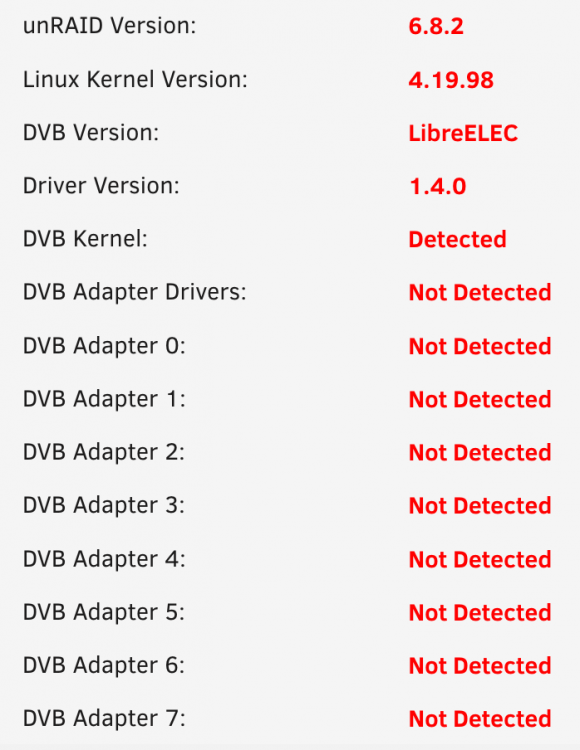

Since 6.8.2 the LibreELEC kernel does not detect my DVB card (based on CX23885) any more (see attached screenshot)
The DVB card worked well in the LibreELEC kernel in 6.8.2. when I had an i3 CPU installed. After I installed a Xeon it stopped being detected (lspci does  not see it).
Any ideas right away, or what additional info would you need to diagnose.
