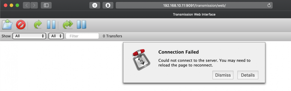

  • I had the same issue. stopped working about a week ago. to get it working i had to do the following   1. log onto pia and generate a noe openvpn config https://www.privateinternetaccess.com/
  • Are you installing on Unraid? Using my repo or another way?   I guess you need to correct some stuff if you are running the command manually some stugg I notice in the command you pasted:   Wher
  • Did you set a variable WHITELIST ?  Mine contains: 192.168.*.*,127.0.0.1,172.*.*.*   Andy is right, the whitelist gets overwritten, other settings can be changed in the settings file, b

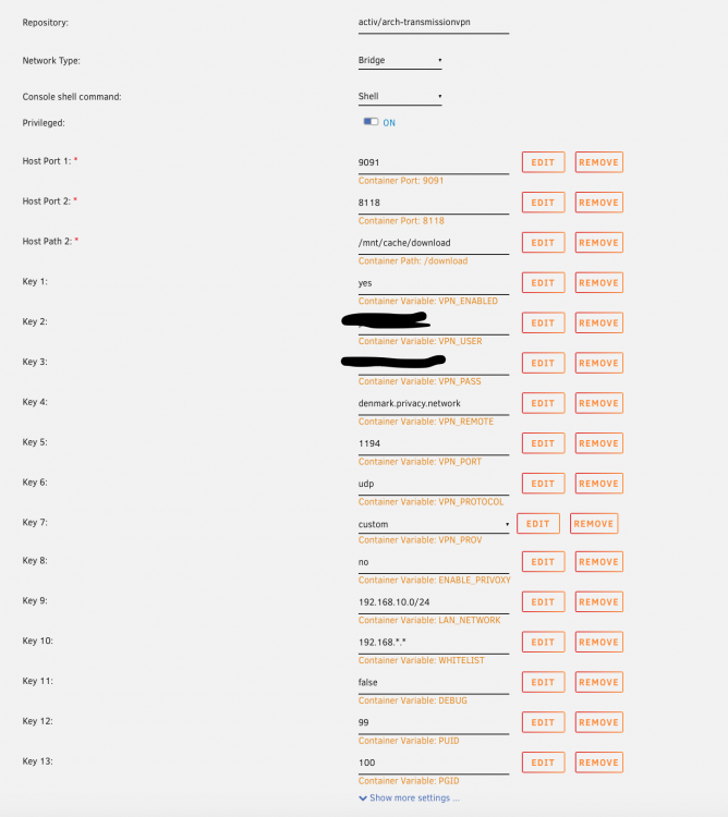

Where it says: VPN_PROV="pia|airvpn|custom" you will need to choose one.
WHITELIST="192.168.*.*" Should be changed to reflect your setup (WHITELIST="10.*.*.*")
VPN_USER="vpn username" -e VPN_PASS="vpn password" need to be set
I specifically think the pipe sign in VPN_PROV is causing your issue.
i was using your repo, i have deleted my origional post because i realised what the problem was (i didnt see that i could change the input on advanced view, im new to unRAID and docker).
I have it sorted now, thanks anyway.

I've got this up and running (thanks!) and it will import .torrents from the interface, but Sonarr (also in a docker container) is asking for a username/password combination and refusing to connect when I try to add it as a download client.  Any ideas why this is happening?
I had the same problem and I think I had to change Whitelist to *.*.*.* in the docker container advance view so it wouldn't block other applications.
Yup, that did it. Thanks.
Just in case anyone else runs into this: Docker uses another IP range inside the container. If you don't want to allow all IP's just whitelist your LAN and the docker internal range.
I didn't know that, thanks.
I added my lan 192.168.1.* and docker 172.17.42.* to the white list and Sonarr connected.
