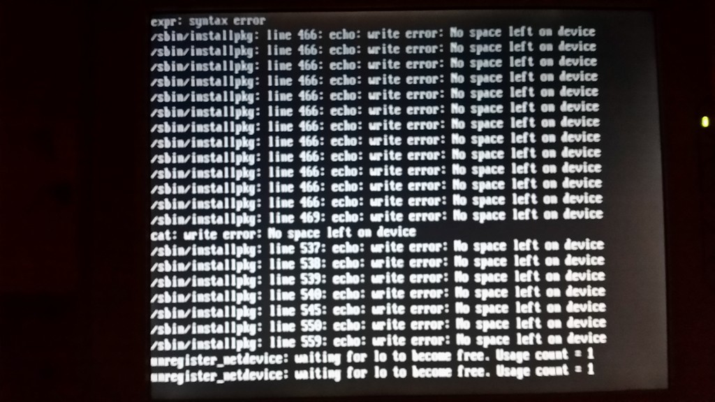

As many have had happen in these parts, I've had 2 unraid boxes freeze, making them entirely useless in all respects. Power off and reboot solves the problem for a while. One box goes down almost weekly. The other lasts 3 weeks or so.

I managed to get a photo of the 24GB machine after it froze... attached.
Thoughts?

In this case, from looking at the installpkg script, it is unable to write to /var/log

What is installpkg script? I have not been manually installing anything when having these freezes.. Unless I'm assuming wrong from the name of that script. Could it perhaps be a permissions thing where some process doesn't have permission to write to the log? Damn i wish I knew more about this stuff. Hopefully one day I'll be helping, not asking for help!
It looks like there might be some similarity in my screen shot to this thread https://lime-technology.com/forum/index.php?topic=41963.0 (Squid? )

Definitely good to try a df -h if you can to see if a filesystem was full (/var/log seems to be the common one to fill up), and of course keep on eye on the %'s in dashboard.  I can say in my case that it wasn't full, when I had the issue, but hopefully you have more luck tracking down the issue than I have had so far :)

installpkg is a slackware script that installs packages.  All installed plugins use it.  Unless you caught when those messages appeared on the screen and we could correlate that to a time in the syslog, its meaningless.  I was just pointing out that those messages on the screen meant that it could write to /var/log (presumably it was trying to write an error message about it unable to write an error message)
Permission on /var/log.  guess its possible, but doubt it.
unregister netdevice (the link you posted) is a harmless but annoying error message that pops up on all open ssh / local terminals.  I usually only see it under heavy i/o on the docker image.
