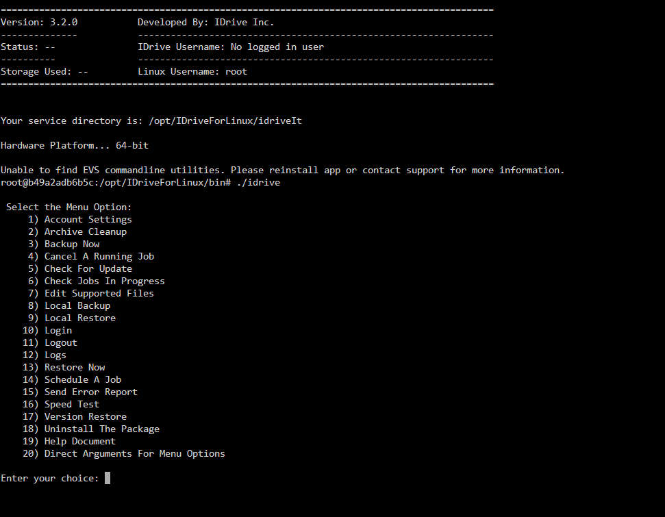

Long time lurker , I have followed the steps through until you have to enter, ./idrive -a
I do this then get the below error, any ideas?
Unable to find EVS commandline utilities

Just to confirm, you are inside the docker container at the # prompt when entering ./idrive -a?
Does ./idrive --account-setting give you the same error?
The screen capture below is me running ./idrive (no options).  When entering the console for the container -- you should immediately be in the path /opt/IDriveForLinux/bin (as shown in the screen capture.
Edited by cyberteer
Yes it does, I can get the options menu as shown here, but whenever I try to do anything with account settings I get the error
I installed using option 1 , just in case that makes a difference?
This was a fresh install, not an upgrade, is it possible that there is a dependency missing in the docker ?

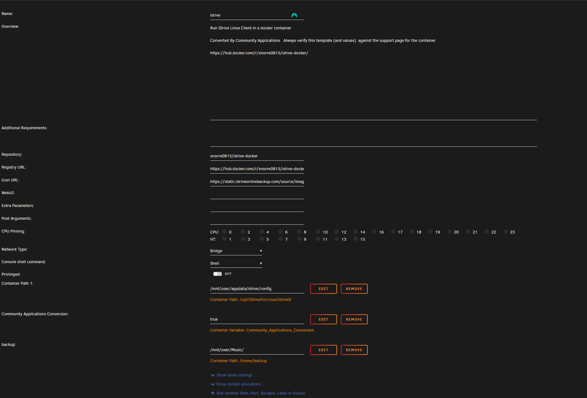

Tried that, had the same  outcome, heres my full config, have I missed something obvious
What is that option "Community Applications Conversion" = true??   It was not in the template and I do not have it in my own config either.  Can you set to "false" or remove it and try again?
I think that gets added automatically when you use the option 1 install, but will see what happens

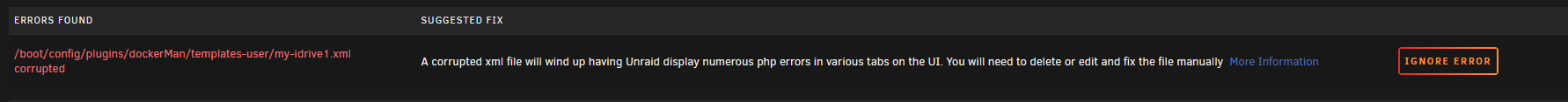

ok so this is very strange, I have tried method 2 again, and although I can create the file
my-idrive.xml
when I try to open the template in Docker , its blank?
And I get the following on the Fix Common Problems plugin
I have now also re-installed docker via the unraid gui, and tried again, same error persists, but all my other dockers came straight back to life after I re-installed them via community apps, with all the data retained, so im quite happy with my docker itself now, so its just this 1

As for the blank template issue, from the filename I am thinking you already had my-idrive.xml as a template -- unless you delete it from the //boot/config/plugins/dockerMan/templates-user directory you shouldn't need to recreate.

@mraerosmith can you try executing:
./idrive -C
and force it to update even if it says it is the same version.
You beauty, that did it, well sort of -c didnt work, just errored for me.
but
./idrive
then option 5 and forcing the update worked perfect, now connecting and backing up.

Ultimately it was a very easy fix but I find it interesting it hit two of us. Overall the container is working great!
Hey @jjross @mraerosmith in regards to the "Unable to find EVS commandline utilities" error you both encountered...  would either of you recall if when you first added the idrive docker if you created a folder/directory under /user/appdata for the idrive docker to use or did you simply let it "auto-create" upon launching the container?
