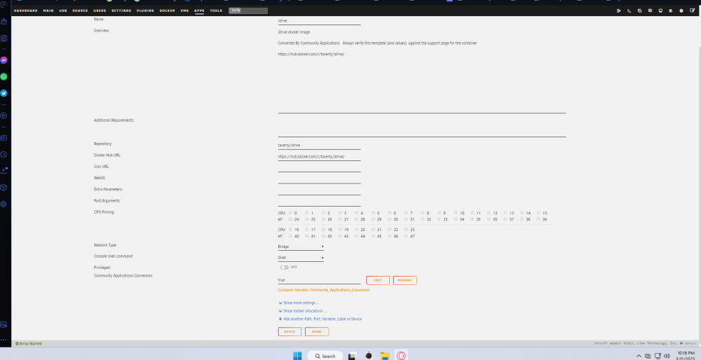

I wrote a fully functioning iDrive docker container about a year ago. It has been working flawlessly since. Auto restarts on server reboots and retains the configuration.
Just make sure to read the installation section and create an empty idrivecrontab.json file before starting the container. Only needs to be done once. Also follow the "First Run" section as well.
https://hub.docker.com/r/taverty/idrive

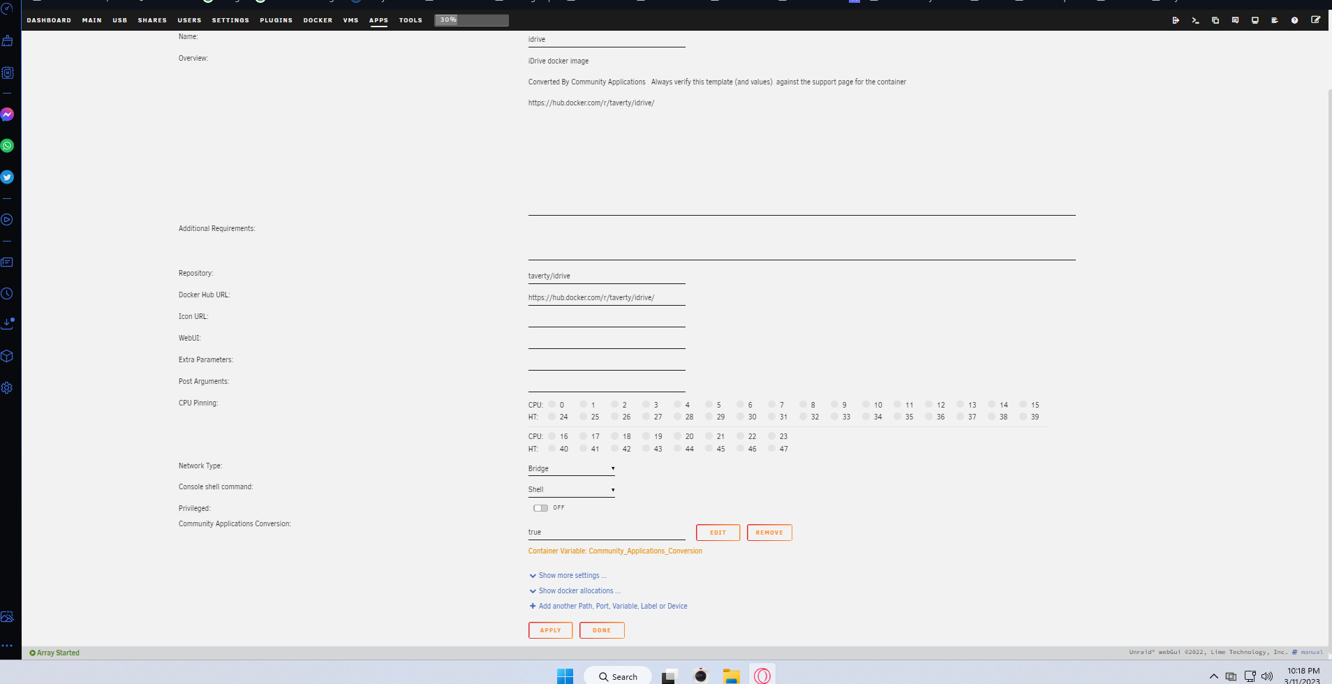

how great it would be to have this in the unraid apps/dockers for easy install but i did pull the container using Community Apps plug in but im not sure what i need to do next..
Edited by ocyberbum
