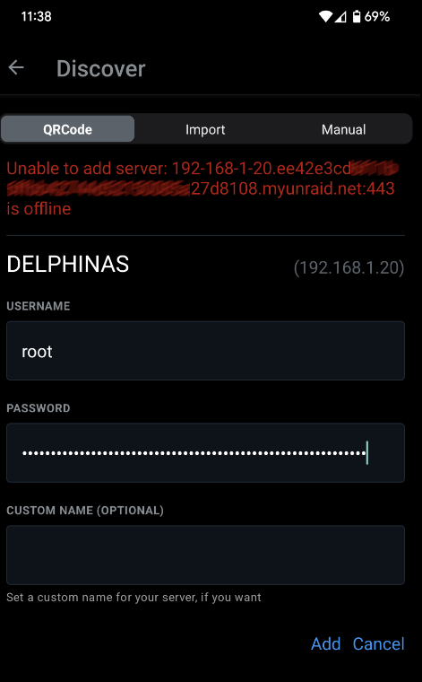

balog Posted September 2 Share Posted September 2 (edited) After updating to the latest version of the plugin I get further with the QR code set up. The below error message appears after entering my username/password and clicking 'Add'. Obviously, my server is online. I scanned the QR code from the plugin settings page, and can confirm my phone with the app and the unraid server are on the same LAN> Edited September 2 by balog Quote Link to comment
jbrodriguez Posted September 2 Author Share Posted September 2 10 hours ago, balog said: After updating to the latest version of the plugin I get further with the QR code set up progress ! you run your server on a port different than 443 ? Quote Link to comment

balog Posted September 2 Share Posted September 2 1 hour ago, jbrodriguez said: progress ! you run your server on a port different than 443 ? Nope. 443 Quote Link to comment
jbrodriguez Posted September 2 Author Share Posted September 2 1 hour ago, balog said: Nope. 443 i see, i think i need to make an additional change, ill look into it today Quote Link to comment
jbrodriguez Posted September 2 Author Share Posted September 2 7 hours ago, balog said: Nope. 443 i published a new version of the app, qr code will work now (this reminds me of the "i'm feeling lucy" button on the google home page ) Quote Link to comment
balog Posted September 3 Share Posted September 3 4 hours ago, jbrodriguez said: i published a new version of the app, qr code will work now (this reminds me of the "i'm feeling lucy" button on the google home page ) Can confirm the QR code registration process works. Thank you so much for your hard work. Did I read somewhere that ControlR is open source now? github? I could be wrong. Am a programmer and would be interested in learning it, to possibly provide some enhancements Quote Link to comment
