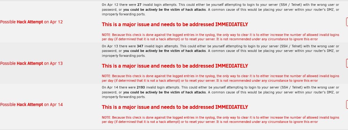

Strange login attempts. Am I being attacked?

hi I just got this error of log in attempts I know I turned off port forwarding on my router  for 22  as I OpenVPN to my remote side comp... but the remote side comp logged more then 2000 login attempts... can you tell by what port is it hitting..
I have it behind a pfsense router    but I cant tell what to look for to block this???  here is copy of some of it and my diagnostic file.. it just popped up toda when I ran fix common issues
and my router isn't setup as DMZ  but is it acting like it then  I mean the router..  but ya I not sure  any input be great
Apr 12 17:06:24 mitchsserver sshd[10628]: Did not receive identification string from 103.89.89.19 port 56742
Apr 12 17:06:25 mitchsserver sshd[10650]: Unable to negotiate with 103.89.89.19 port 56765: no matching key exchange method found. Their offer: diffie-hellman-group1-sha1 [preauth]
Apr 12 17:06:26 mitchsserver sshd[10655]: Unable to negotiate with 103.89.89.19 port 56787: no matching key exchange method found. Their offer: diffie-hellman-group1-sha1 [preauth]
Apr 12 17:06:26 mitchsserver sshd[10656]: Unable to negotiate with 103.89.89.19 port 56803: no matching key exchange method found. Their offer: diffie-hellman-group1-sha1 [preauth]
Apr 12 17:06:26 mitchsserver sshd[10657]: Unable to negotiate with 103.89.89.19 port 56820: no matching key exchange method found. Their offer: diffie-hellman-group1-sha1 [preauth]
Apr 12 17:06:26 mitchsserver sshd[10677]: Unable to negotiate with 103.89.89.19 port 56849: no matching key exchange method found. Their offer: diffie-hellman-group1-sha1 [preauth]
Apr 12 17:06:26 mitchsserver sshd[10679]: Unable to negotiate with 103.89.89.19 port 56868: no matching key exchange method found. Their offer: diffie-hellman-group1-sha1 [preauth]
Apr 12 17:06:26 mitchsserver sshd[10681]: Unable to negotiate with 103.89.89.19 port 56886: no matching key exchange method found. Their offer: diffie-hellman-group1-sha1 [preauth]
Apr 12 17:06:26 mitchsserver sshd[10683]: Unable to negotiate with 103.89.89.19 port 56899: no matching key exchange method found. Their offer: diffie-hellman-group1-sha1 [preauth]
Apr 12 17:06:27 mitchsserver sshd[10690]: Unable to negotiate with 103.89.89.19 port 56920: no matching key exchange method found. Their offer: diffie-hellman-group1-sha1 [preauth]
Apr 12 17:06:28 mitchsserver sshd[10710]: Unable to negotiate with 103.89.89.19 port 56939: no matching key exchange method found. Their offer: diffie-hellman-group1-sha1 [preauth]
Apr 12 17:06:29 mitchsserver sshd[10736]: Unable to negotiate with 103.89.89.19 port 56962: no matching key exchange method found. Their offer: diffie-hellman-group1-sha1 [preauth]
Apr 12 17:06:29 mitchsserver sshd[10737]: Unable to negotiate with 103.89.89.19 port 56978: no matching key exchange method found. Their offer: diffie-hellman-group1-sha1 [preauth]
Apr 12 17:06:29 mitchsserver sshd[10738]: Unable to negotiate with 103.89.89.19 port 56989: no matching key exchange method found. Their offer: diffie-hellman-group1-sha1 [preauth]
Apr 12 17:06:29 mitchsserver sshd[10739]: Unable to negotiate with 103.89.89.19 port 57003: no matching key exchange method found. Their offer: diffie-hellman-group1-sha1 [preauth]
Apr 12 17:06:29 mitchsserver sshd[10740]: Unable to negotiate with 103.89.89.19 port 57015: no matching key exchange method found. Their offer: diffie-hellman-group1-sha1 [preauth]
Apr 12 17:21:09 mitchsserver sshd[29175]: Received disconnect from 222.161.209.43 port 56296:11: Bye Bye [preauth]
Apr 12 17:21:09 mitchsserver sshd[29175]: Disconnected from 222.161.209.43 port 56296 [preauth]
Apr 12 17:44:54 mitchsserver sshd[26632]: Did not receive identification string from 103.89.89.19 port 61750
Apr 12 17:44:55 mitchsserver sshd[26654]: Unable to negotiate with 103.89.89.19 port 61757: no matching key exchange method found. Their offer: diffie-hellman-group1-sha1 [preauth]
Apr 12 17:44:56 mitchsserver sshd[26677]: Unable to negotiate with 103.89.89.19 port 61759: no matching key exchange method found. Their offer: diffie-hellman-group1-sha1 [preauth]
Apr 12 17:44:56 mitchsserver sshd[26678]: Unable to negotiate with 103.89.89.19 port 61761: no matching key exchange method found. Their offer: diffie-hellman-group1-sha1 [preauth]
Apr 12 17:44:56 mitchsserver sshd[26679]: Unable to negotiate with 103.89.89.19 port 61764: no matching key exchange method found. Their offer: diffie-hellman-group1-sha1 [preauth]
Apr 12 17:44:56 mitchsserver sshd[26682]: Unable to negotiate with 103.89.89.19 port 61769: no matching key exchange method found. Their offer: diffie-hellman-group1-sha1 [preauth]
Apr 12 17:44:56 mitchsserver sshd[26680]: Unable to negotiate with 103.89.89.19 port 61767: no matching key exchange method found. Their offer: diffie-hellman-group1-sha1 [preauth]
Apr 12 17:44:57 mitchsserver sshd[26686]: Unable to negotiate with 103.89.89.19 port 61787: no matching key exchange method found. Their offer: diffie-hellman-group1-sha1 [preauth]
Apr 12 17:44:57 mitchsserver sshd[26684]: Unable to negotiate with 103.89.89.19 port 61774: no matching key exchange method found. Their offer: diffie-hellman-group1-sha1 [preauth]
Apr 12 17:44:57 mitchsserver sshd[26687]: Unable to negotiate with 103.89.89.19 port 61786: no matching key exchange method found. Their offer: diffie-hellman-group1-sha1 [preauth]
Apr 12 17:44:57 mitchsserver sshd[26685]: Unable to negotiate with 103.89.89.19 port 61776: no matching key exchange method found. Their offer: diffie-hellman-group1-sha1 [preauth]
Apr 12 17:44:57 mitchsserver sshd[26691]: Unable to negotiate with 103.89.89.19 port 61794: no matching key exchange method found. Their offer: diffie-hellman-group1-sha1 [preauth]
Apr 12 17:44:57 mitchsserver sshd[26692]: Unable to negotiate with 103.89.89.19 port 61796: no matching key exchange method found. Their offer: diffie-hellman-group1-sha1 [preauth]
Apr 12 17:44:57 mitchsserver sshd[26718]: Unable to negotiate with 103.89.89.19 port 61798: no matching key exchange method found. Their offer: diffie-hellman-group1-sha1 [preauth]
Apr 12 17:44:58 mitchsserver sshd[26725]: Unable to negotiate with 103.89.89.19 port 61806: no matching key exchange method found. Their offer: diffie-hellman-group1-sha1 [preauth]
Apr 12 17:44:58 mitchsserver sshd[26726]: Unable to negotiate with 103.89.89.19 port 61810: no matching key exchange method found. Their offer: diffie-hellman-group1-sha1 [preauth]
Apr 12 17:57:48 mitchsserver sshd[10496]: Received disconnect from 223.111.139.211 port 44290:11:  [preauth]
Apr 12 17:57:48 mitchsserver sshd[10496]: Disconnected from 223.111.139.211 port 44290 [preauth]
Apr 12 17:57:49 mitchsserver sshd[10498]: Received disconnect from 223.111.139.247 port 57026:11:  [preauth]
Apr 12 17:57:49 mitchsserver sshd[10498]: Disconnected from 223.111.139.247 port 57026 [preauth]
Apr 12 17:57:49 mitchsserver sshd[10504]: Received disconnect from 36.156.24.94 port 37762:11:  [preauth]
Apr 12 17:57:49 mitchsserver sshd[10504]: Disconnected from 36.156.24.94 port 37762 [preauth]
Apr 12 17:57:49 mitchsserver sshd[10500]: Received disconnect from 223.111.139.211 port 44611:11:  [preauth]
Apr 12 17:57:49 mitchsserver sshd[10500]: Disconnected from 223.111.139.211 port 44611 [preauth]
Apr 12 17:57:49 mitchsserver sshd[10502]: Received disconnect from 36.156.24.94 port 37592:11:  [preauth]
Apr 12 17:57:49 mitchsserver sshd[10502]: Disconnected from 36.156.24.94 port 37592 [preauth]
Apr 12 17:57:49 mitchsserver sshd[10509]: Received disconnect from 223.68.10.247 port 38767:11:  [preauth]
Apr 12 17:57:49 mitchsserver sshd[10509]: Disconnected from 223.68.10.247 port 38767 [preauth]
Apr 12 17:57:49 mitchsserver sshd[10511]: Received disconnect from 223.111.139.239 port 33860:11:  [preauth]
Apr 12 17:57:49 mitchsserver sshd[10511]: Disconnected from 223.111.139.239 port 33860 [preauth]
Apr 12 17:57:49 mitchsserver sshd[10513]: Received disconnect from 223.111.139.244 port 45468:11:  [preauth]
Apr 12 17:57:49 mitchsserver sshd[10513]: Disconnected from 223.111.139.244 port 45468 [preauth]
Apr 12 17:57:49 mitchsserver sshd[10515]: Received disconnect from 36.156.24.94 port 39178:11:  [preauth]
Apr 12 17:57:49 mitchsserver sshd[10515]: Disconnected from 36.156.24.94 port 39178 [preauth]
Apr 12 17:57:49 mitchsserver sshd[10517]: Received disconnect from 223.111.139.210 port 44240:11:  [preauth]
Apr 12 17:57:49 mitchsserver sshd[10517]: Disconnected from 223.111.139.210 port 44240 [preauth]
Apr 12 17:57:49 mitchsserver sshd[10519]: Received disconnect from 36.156.24.98 port 35873:11:  [preauth]
Apr 12 17:57:49 mitchsserver sshd[10519]: Disconnected from 36.156.24.98 port 35873 [preauth]
Apr 12 17:57:49 mitchsserver sshd[10521]: Received disconnect from 223.111.139.239 port 36495:11:  [preauth]
Apr 12 17:57:49 mitchsserver sshd[10521]: Disconnected from 223.111.139.239 port 36495 [preauth]
Apr 12 17:57:50 mitchsserver sshd[10541]: Received disconnect from 119.249.54.236 port 40852:11:  [preauth]
Apr 12 17:57:50 mitchsserver sshd[10541]: Disconnected from 119.249.54.236 port 40852 [preauth]
Apr 12 17:57:50 mitchsserver sshd[10546]: Received disconnect from 223.68.10.247 port 43389:11:  [preauth]
Apr 12 17:57:50 mitchsserver sshd[10546]: Disconnected from 223.68.10.247 port 43389 [preauth]
Apr 12 17:57:50 mitchsserver sshd[10548]: Received disconnect from 36.156.24.99 port 55128:11:  [preauth]
Apr 12 17:57:50 mitchsserver sshd[10548]: Disconnected from 36.156.24.99 port 55128 [preauth]
Apr 12 17:57:50 mitchsserver sshd[10568]: Received disconnect from 36.156.24.98 port 38491:11:  [preauth]
Apr 12 17:57:50 mitchsserver sshd[10568]: Disconnected from 36.156.24.98 port 38491 [preauth]
Apr 12 17:57:51 mitchsserver sshd[10572]: Received disconnect from 223.111.139.211 port 50372:11:  [preauth]
Apr 12 17:57:51 mitchsserver sshd[10572]: Disconnected from 223.111.139.211 port 50372 [preauth]
Apr 12 17:57:51 mitchsserver sshd[10570]: Received disconnect from 223.111.139.211 port 50089:11:  [preauth]
Apr 12 17:57:51 mitchsserver sshd[10570]: Disconnected from 223.111.139.211 port 50089 [preauth]
Apr 12 17:57:51 mitchsserver sshd[10577]: Received disconnect from 122.226.181.166 port 42514:11:  [preauth]
Apr 12 17:57:51 mitchsserver sshd[10577]: Disconnected from 122.226.181.166 port 42514 [preauth]
Apr 12 17:57:53 mitchsserver sshd[10622]: Received disconnect from 61.184.247.11 port 47516:11:  [preauth]
Apr 12 17:57:53 mitchsserver sshd[10622]: Disconnected from 61.184.247.11 port 47516 [preauth]
Apr 12 17:57:53 mitchsserver sshd[10624]: Received disconnect from 223.111.139.210 port 56049:11:  [preauth]
Apr 12 17:57:53 mitchsserver sshd[10624]: Disconnected from 223.111.139.210 port 56049 [preauth]
Apr 12 17:57:53 mitchsserver sshd[10602]: Received disconnect from 222.187.225.10 port 49449:11:  [preauth]
Apr 12 17:57:53 mitchsserver sshd[10602]: Disconnected from 222.187.225.10 port 49449 [preauth]
Apr 12 17:57:53 mitchsserver sshd[10629]: Received disconnect from 122.226.181.166 port 55364:11:  [preauth]
Apr 12 17:57:53 mitchsserver sshd[10629]: Disconnected from 122.226.181.166 port 55364 [preauth]
Apr 12 17:57:53 mitchsserver sshd[10631]: Received disconnect from 36.156.24.95 port 32787:11:  [preauth]
Apr 12 17:57:53 mitchsserver sshd[10631]: Disconnected from 36.156.24.95 port 32787 [preauth]
Apr 12 17:57:53 mitchsserver sshd[10633]: Received disconnect from 223.111.139.244 port 33917:11:  [preauth]
Apr 12 17:57:53 mitchsserver sshd[10633]: Disconnected from 223.111.139.244 port 33917 [preauth]
Apr 12 17:57:53 mitchsserver sshd[10653]: Received disconnect from 36.156.24.99 port 46646:11:  [preauth]
Apr 12 17:57:53 mitchsserver sshd[10653]: Disconnected from 36.156.24.99 port 46646 [preauth]
Apr 12 17:57:54 mitchsserver sshd[10658]: Received disconnect from 36.156.24.99 port 48152:11:  [preauth]
Apr 12 17:57:54 mitchsserver sshd[10658]: Disconnected from 36.156.24.99 port 48152 [preauth]
Apr 12 17:57:54 mitchsserver sshd[10662]: Received disconnect from 61.184.247.11 port 53757:11:  [preauth]
Apr 12 17:57:54 mitchsserver sshd[10662]: Disconnected from 61.184.247.11 port 53757 [preauth]
Apr 12 17:57:54 mitchsserver sshd[10664]: Received disconnect from 36.156.24.95 port 35272:11:  [preauth]
Apr 12 17:57:54 mitchsserver sshd[10664]: Disconnected from 36.156.24.95 port 35272 [preauth]
Apr 12 17:57:54 mitchsserver sshd[10660]: Received disconnect from 222.187.225.10 port 54629:11:  [preauth]
Apr 12 17:57:54 mitchsserver sshd[10660]: Disconnected from 222.187.225.10 port 54629 [preauth]
Apr 12 17:57:56 mitchsserver sshd[10708]: Received disconnect from 115.238.245.2 port 49866:11:  [preauth]
Apr 12 17:57:56 mitchsserver sshd[10708]: Disconnected from 115.238.245.2 port 49866 [preauth]
Apr 12 17:57:57 mitchsserver sshd[10600]: Received disconnect from 115.238.245.2 port 39668:11:  [preauth]
Apr 12 17:57:57 mitchsserver sshd[10600]: Disconnected from 115.238.245.2 port 39668 [preauth]
mitchsserver-diagnostics-20190417-1351.zip
