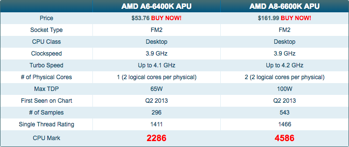

Even on what I consider to be a P.O.S. cpu in my main server, I don't think its that bad:
raid6: using algorithm sse2x4 gen() 13394 MB/s
Interesting. By all accounts my A6 6400K ought to be even more of a POS than your A8 6600K, except for its power consumption, but at stock speed I get
raid6: using algorithm sse2x4 gen() 13824 MB/s
I'm actually rather fond of those AMD APUs, and the AM1 Kabinis are great value for everyday use.
Memory configuration and speed will also play a part
I agree, but is the speed quoted per core or total? Our processors are essentially the same, except that yours has twice as many cores and a better GPU.
Two 8 GB sticks of DDR3-1600, btw. Asus A88M-A mobo (again, very similar to yours but less capable), SAS-LP HBA (compared with your SAS2).
