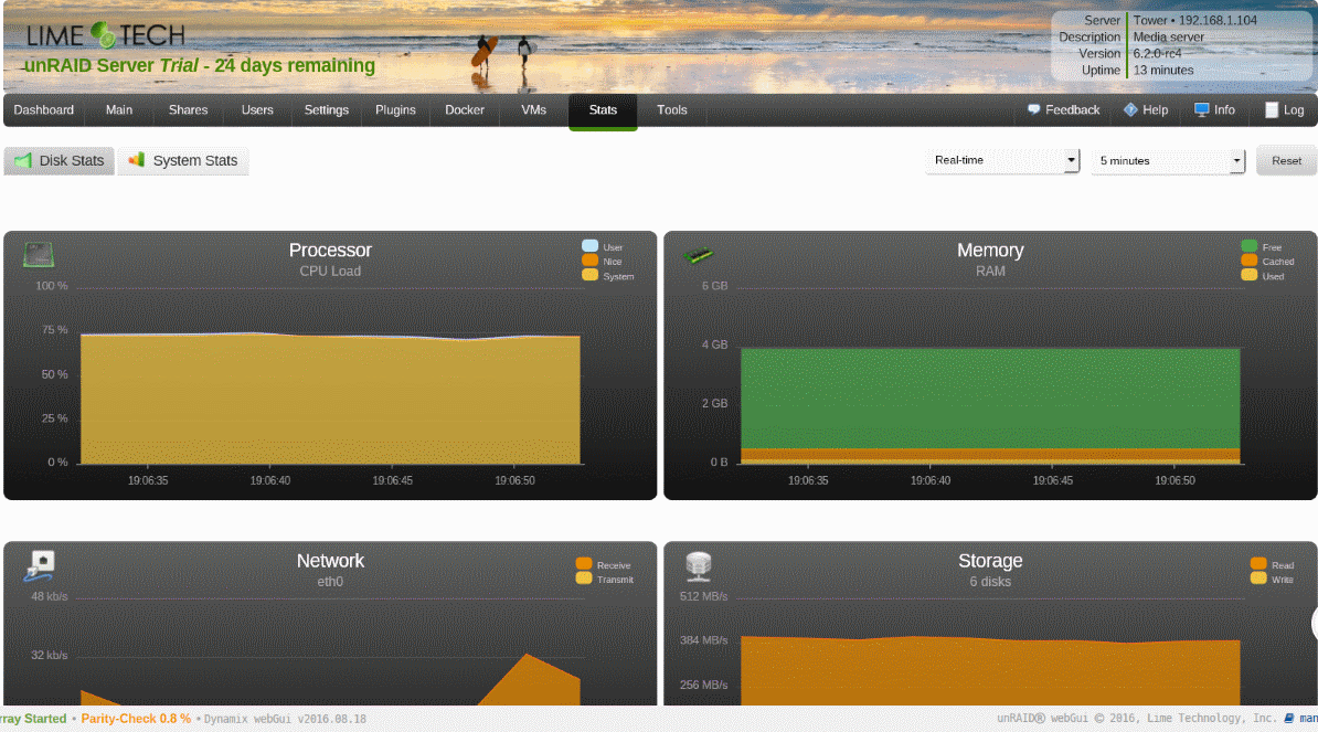

Frank, you may want to try the new rc4, CPU utilization with dual parity is as low as it ever been, same as beta18.
Will do.  Have just installed update and assigned the same drive again as the Parity 2 disk.  Parity sync is now in progress. That speed will give the first clue as any improvement.  Be back with results tomorrow.

Looking at the second link, it appears that any Intel Processor released before Sandy Bridge in 2011 and any AMD Processor before Bulldozer will be behind the eight ball.  And if it is low power then the situation is a double whammy.
EDIT: And it does help to explain why there was not decent correlation of speed results with Passmark numbers...
