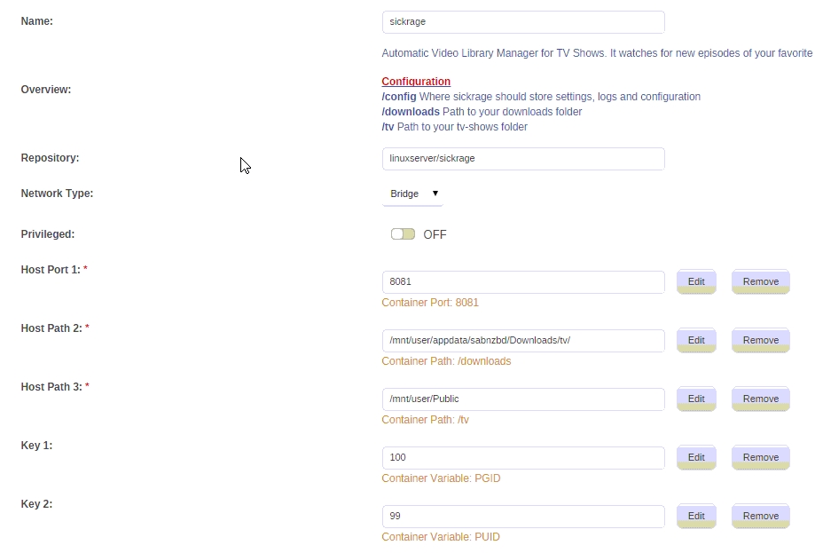

Further to this, I installed a Docker version of SickRage and restored the config from the plugin version.  The docker paths are pointing the the same path as the plugin paths.  Files end up in the proper spot and not on that cache drive.

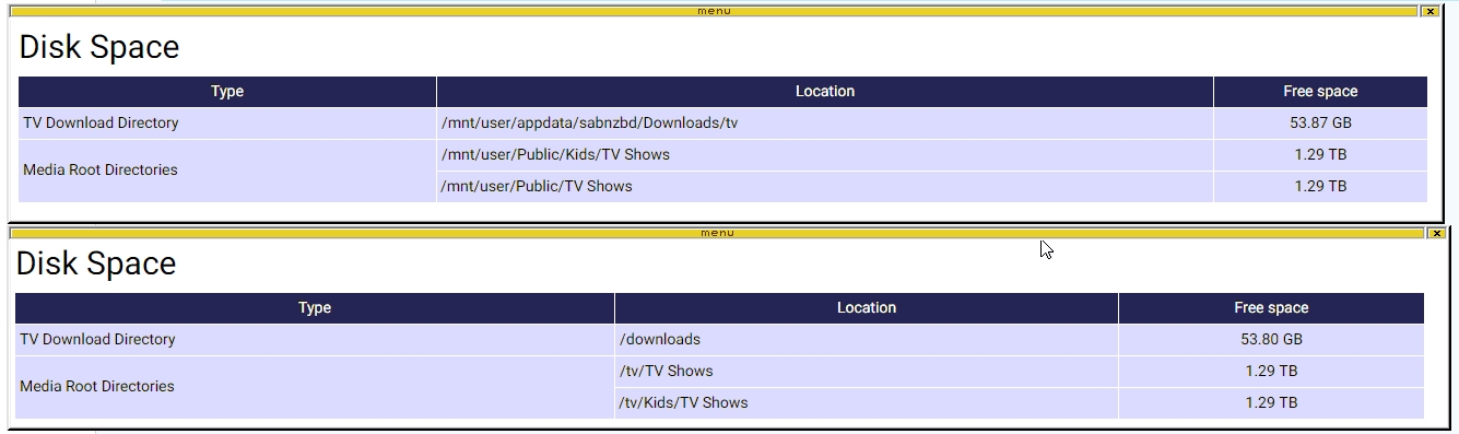

I have attached a screen shot of the directory difference from plugin (top) to docker (bottom).  The /tv path in the docker config is set to be /mnt/user/Public which is the share that is set to not cache.

You should include screenshots showing the docker container settings so we can see what the directory mapping is set to.
I mentioned it in the post above, but there is a screen shot
