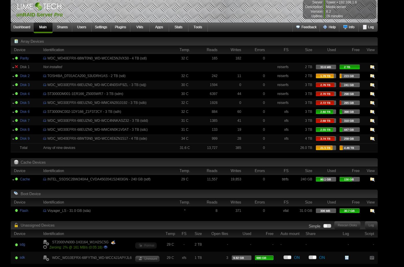

I've now started pre-clearing the drive as nothing else I could do seemed to show it as XFS. It's an empty drive. Even removing the partition and formatting to XFS through the unassigned devices plugin, when I add it back to the array, it says ReiserFS. Which is odd, because when I stop the array, and un-assign the drive, it shows in unassigned devices as XFS. I have refreshed my browser cache to be sure it wasn't just showing that way, and when this drive is added back it displays as ReiserFS. I'm all for moving all my drives to XFS, as it seems this is the root of my problem, is there an easier way than doing a new config for each drive?

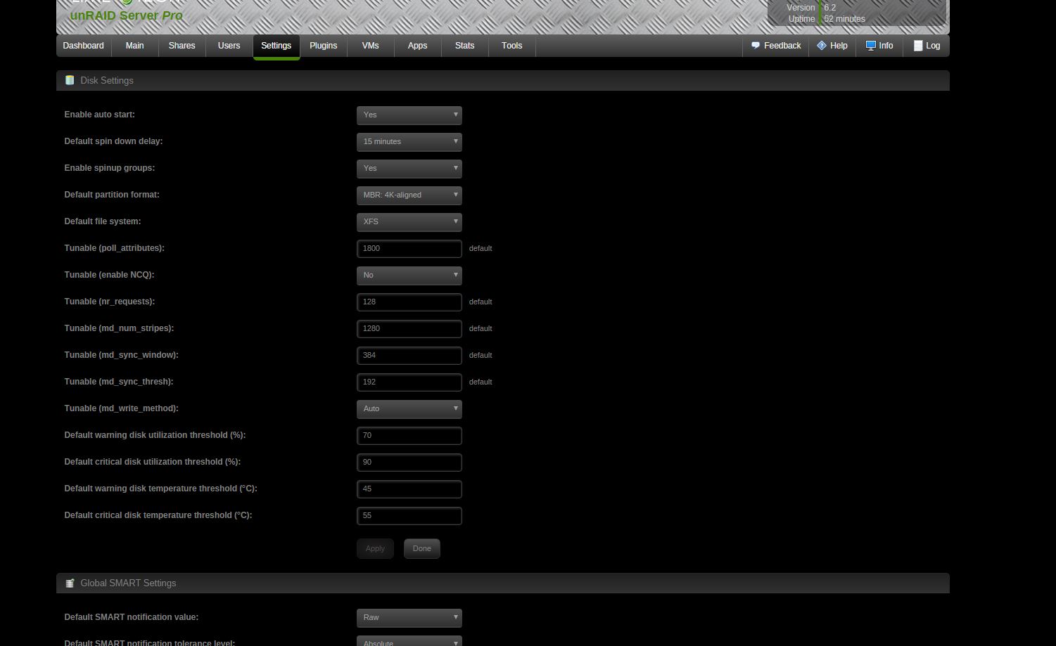

have you checked in settings | disks (?) for the default array disk format?

When I've deleted the partition through unassigned devices (having to type "Yes") and then click format, it says XFS, and I also have to type "Yes" for that. But when I add it back in, it still shows as resierfs. Even stopping the array and un assigning it, shows in unassigned devices as xfs.
That is the Disk Settings page, which is the settings for all disks. Where you need to go is the Settings page for the specific disk by clicking on the disk itself in Main.

thanks trurl, I had been all over the forums and I missed this somehow. So to achieve getting this disk back into the disk 1 position as XFS, I must preclear it, assign it to a new slot, and exclude this disk from user shares. Then stop the array and switch this disk back to the disk1 position? Would that be the correct way to do this? I'm reading your post, and I have another blank drive, I just don't have another SATA port so I'm trying to follow half way along as my scenario is a bit different.
From your screenshot, it would appear that you are confusing the physical disk which is currently formatted as XFS with the emulated disk1 which is still formatted ReiserFS. As long as the emulated disk is still ReiserFS, every time you put a drive back in that slot, unraid will dutifully erase what is on the physical disk and put the emulated format back on, just like what happens when a disk fails. In order to change the format, you have to stop the array, change the format for the disk1 slot by clicking on disk1, and then starting the array. It will then say that disk1 is unmountable, and offer to format it. When you click the checkbox to accept it, it will proceed to format the disk in the type you set for that disk.
This behavior will happen as long as parity remains valid. If you set a new configuration, you can force unraid to use what is on the physical disk and rebuild parity from all your physical disks, whatever format they happen to be.
So I have transferred the entire contents of drive1, one of my reiserfs drives, to another drive. I have tried stopping the array, removing the partition on disk1, formatting to xfs, and no matter what I do, it keeps appearing in the MAIN tab as reiserfs. Even when I stop the array, unassign the disk, it shows in unassigned devices as xfs, but when I try to add it back to the array, it shows as resierfs. So I have one empty disk, disk1. What is the correct method to format it to xfs and add it back into the array as a new, blank disk with nothing on it?

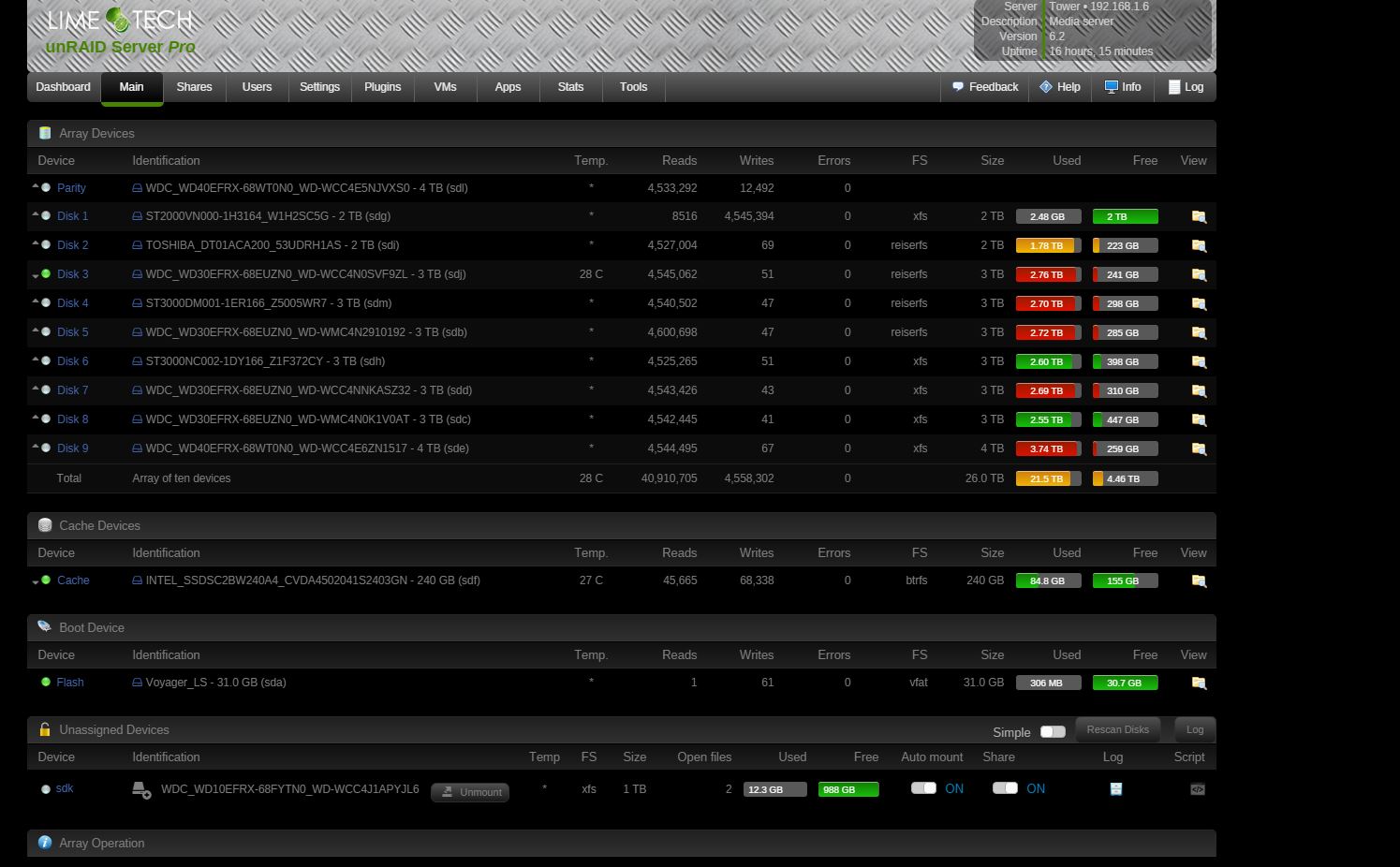

I don't think it's just me saarg, as there are reports of similar within the previous mentioned unbalance post. I've successfully gotten my drive1 to XFS, but however I did it forced a parity check. Moving forward, attached is my MAIN screenshot. How can I move disk2's contents to disk1, and change it's format to XFS without forcing a parity check. I really tried to follow the instructions, but the way I did it still forced a parity check. Any way some gracious person could give me a step by step to move disk2's contents to disk1 and change it's format to XFS without forcing a parity check?
Thanks you SO much in advance for all of the help. Also, with the drive with the most free space (disk1) being XFS, all of my sonarr and couchpotato problems have disappeared and things seem to be smooth sailing.
Once you empty a drive you can just stop the array, click on the drive to go to its settings page, and change its format. When you start unRAID will format it, and parity will be updated when the new filesystem is written so parity will remain in sync.
I feel silly for it being that easy. So the drive just needs to be empty, and then changing it within the disk settings and letting unRAID format it is sufficient? Thanks again so much.

Got it. I really appreciate all the help. I'm slowly getting these drives converted. One thing I am going to run into though....if you see the above picture of my MAIN tab, I am going to be left in a situation where I will have just under 3TB of things to copy, but I'll have to split them among multiple drives to accomplish copying my 1st 3TB drive. Can I still use rsync just on certain directories or what would be the best plan of action? I still also have a 4TB WD Red sitting here, pre-cleared, just no more SATA ports to plug any more drives into. What would be my best move? Just remove one of the 3TB drives, add the 4TB and let parity rebuild the data? I plan on purchasing another 8 port SATA PCI card in the near future as the new case I have allows space for 20 drives, but atm, I am limited to 12. Any more guidance would be greatly appreciated.
