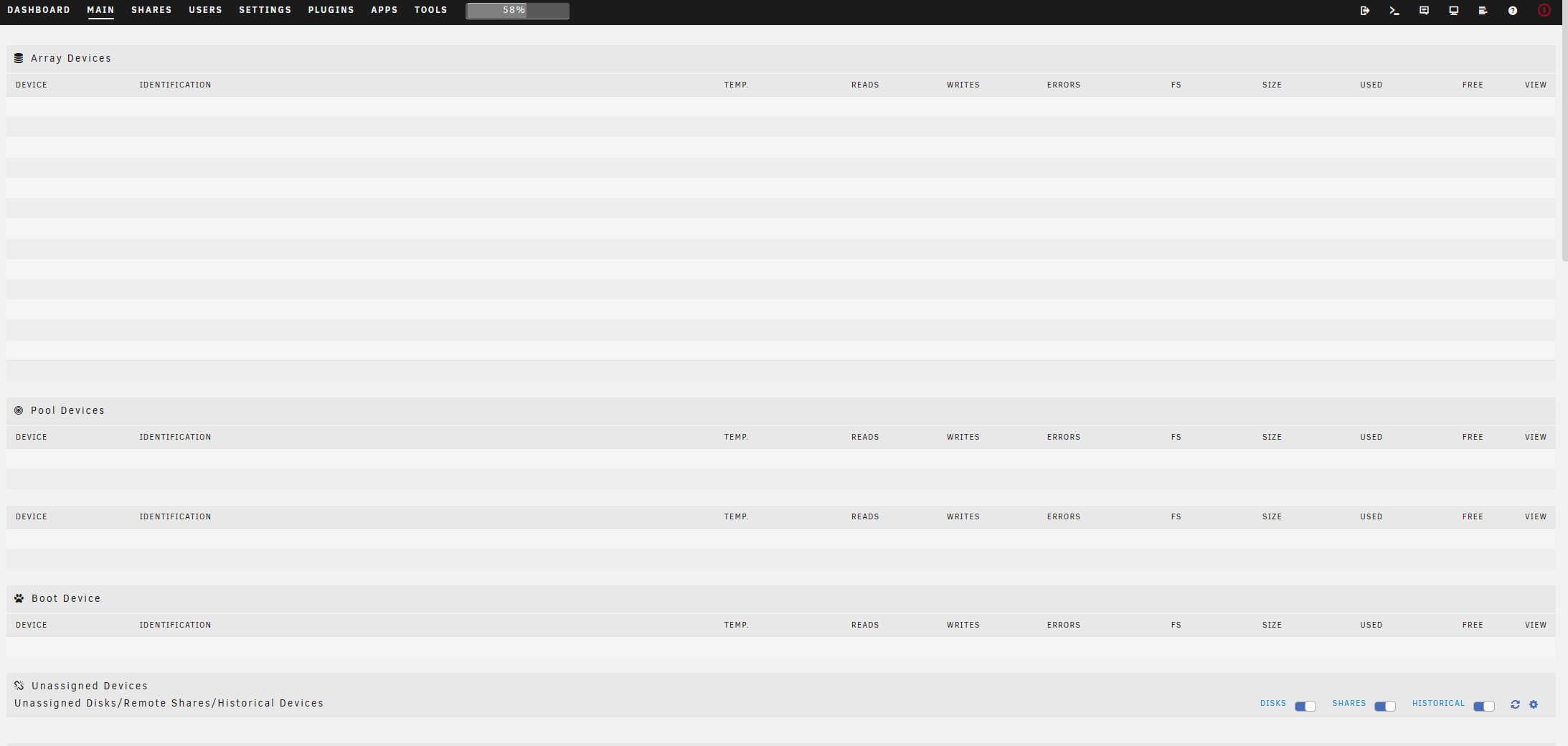

I tried this on my Unraid 6.11.5 system and, unfortunately, it blanked out the view of all drives in my array. I had logged out of the UI and also bounced NGNIX. I rolled it back right away.
