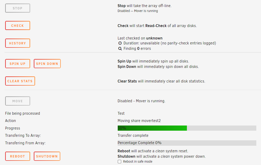

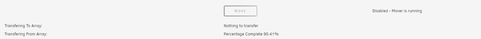

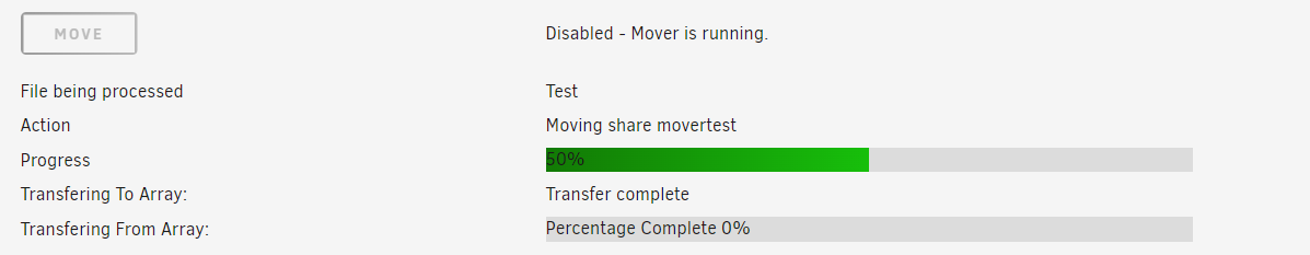

  • I have submitted a pull request for consideration. Initially this will only update after each share being transferred and just shows a percentage complete.     Status will also up
  • It needs to be released but not currently in base os awaiting validate and merge by limetech.
  • I have changed the format of the status, Some of the data is static or test data and not very granular at present as changes needed to core Unraid functions to provide that level of detail.
I'd love that feature too. I suggested it to the mover-tuner-plugin author, but he isn't sure if he can implement it.
Status will also update for scheduled moves. The transfers to and from are sequential so you will not see both at the same time.  From would say 0% complete until To had finished or will show nothing to transfer if that is the case.
Static test data is File name, Progress.
Transfer data is only updated at the end of a share transfer. PR is here https://github.com/limetech/webgui/pull/1042
