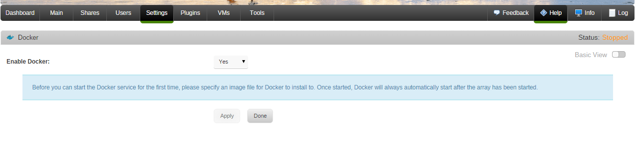

Today I've updated UNRAID to version 6.2.3.The update asked for a system reboot. After the reboot something strange happened. The DOCKER tab is missing.
On Settings another strange thing. When I choose settings\docker I can see that docker is not started. It shows an error message:
"Before you can start the Docker service for the first time, please specify an image file for Docker to install to. Once started, Docker will always automatically start after the array has been started."
But there's no way to chose again the image file for docker (please see attached print screen).
Can you please help?

The system knows where your image is, but is having trouble with mounting it.  It *believes* that its 100% full.  Whether this is true or not, your only choice here is to hit advanced on the settings - docker settings screen.
Set Use Docker to No,
Delete the image if its there, then recreate it, and add the apps back in via CA's previous apps section.

I've done what Squid told: I've renamed the old img file from docker and created a new one (this time with 30GB - hope that's enough).
Meanwhile I've reinstalled all the containers needed and everything was ok.
