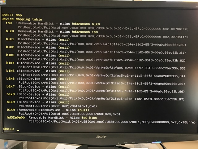

I was trying out several options and when I did change something in the bios, I saw this screen. I am not sure why or what it means.
Thats the UEFI shell, unRAID only support legacy/bios boot.
