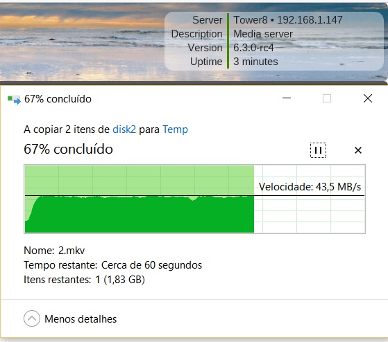

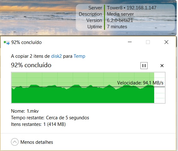

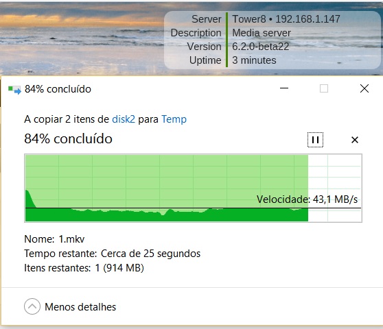

For some time I've been noticing a considerably slower (about half what it should be) read speed from most/all of my servers, and I'm not the only one, it doesn't happen always but more than 50% of reads.
I finally had some time to investigate, tested on more than one server, some of them with nothing in common hardware wise, and this example is from a small server I use at work for temporary client backups, since it's the one where the issue is always reproducible.
I completed formatted the flash drive to test with a clean install, no plugins installed and using default settings.
Disks used are not very fast but still capable of ~100MB/s as you see in the v6.2.0-beta21 screenshot, starting with beta22 read speed goes to about half what it should be.
Write speed is not affected and whatever the issue is is still present on 6.3.0-rc4.
Edit: forgot to mention, same low read speed copying from disk or user shares.
tower8-diagnostics-20161118-0436.zip

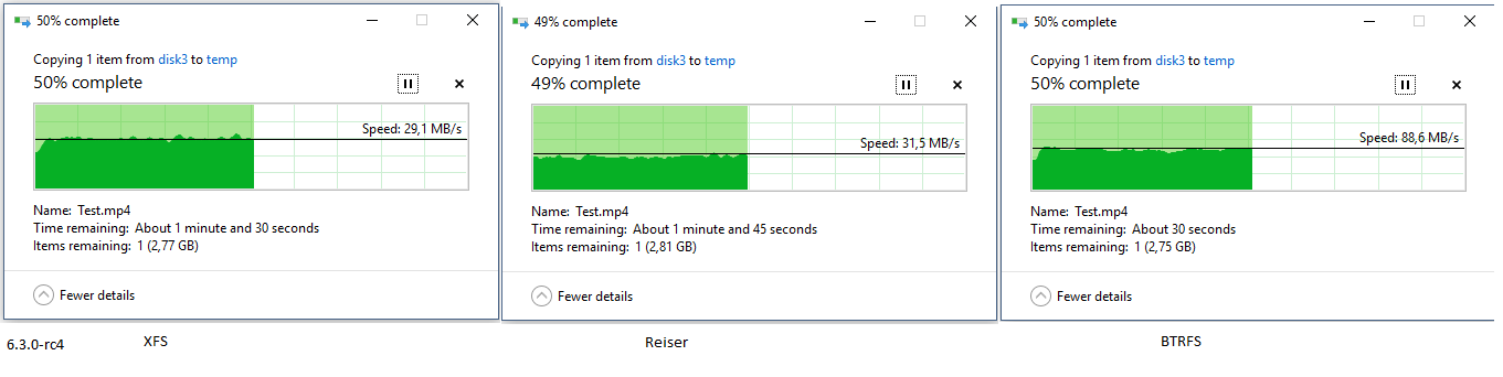

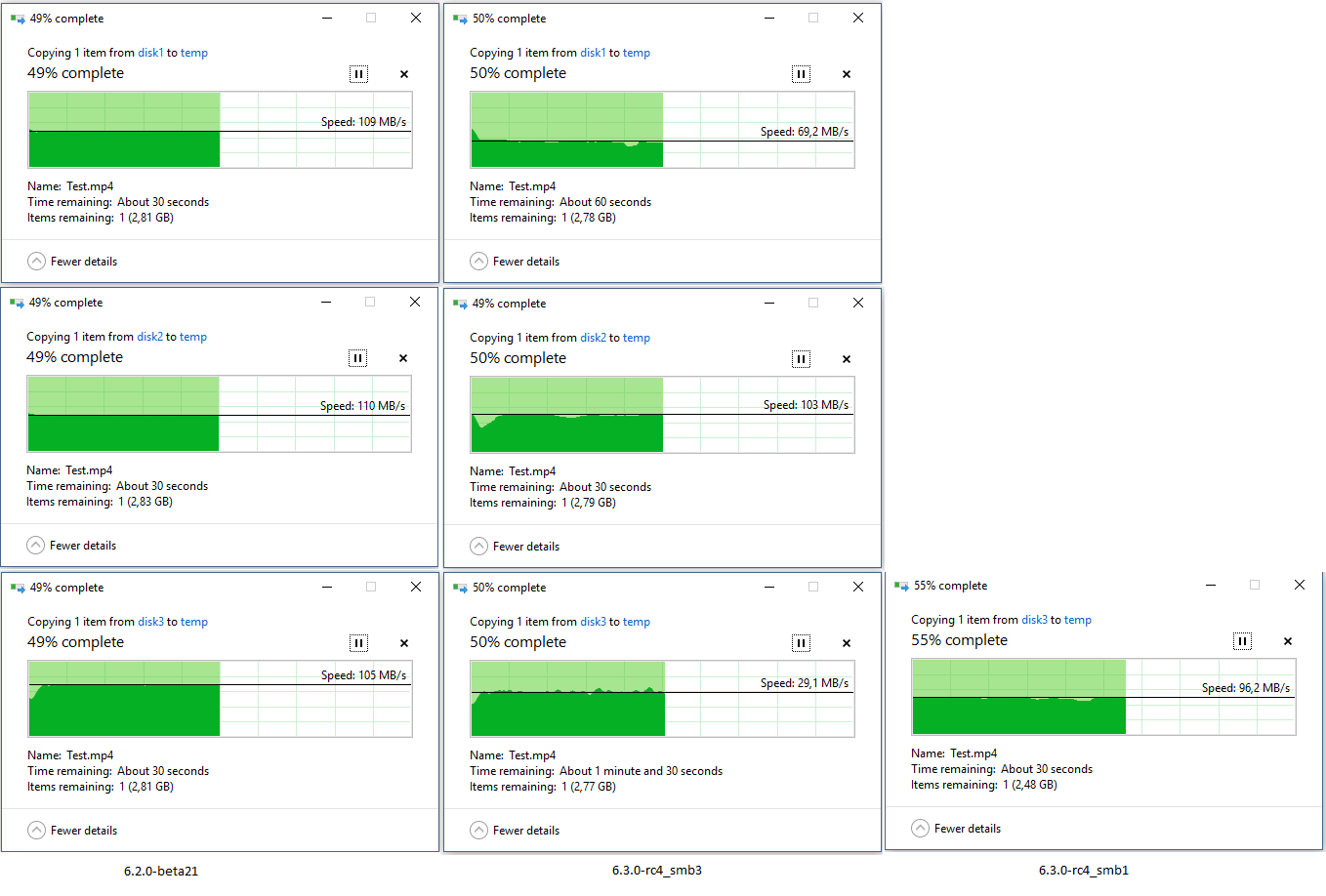

After some more testing I believe the slowdown is related to Samba and SMB3, but this is a strange issue, it doesn't affect all devices the same way, for some reason some disks are much more affected than others, see screenshot below where I compare 3 disks on the same server, between 6.0.0-beta21 and 6.3.0-rc4.
A few more observations:
-Windows 7 is not affected
-Transfers from one unRAID directly to another are not affected
-Server hardware seems irrelevant, tested AMD and Intel, onboard SATA and HBA, different NICs, always same results
-Some devices apparently continue to operate at normal speed, eg, I can copy from my NVMe cache device at 500MB/s+
-For some reason BTRFS formatted disks are much less affected than if XFS or Reiser is used.
-To get decent performance on the worst affected disks post 6.0.0-beta22 I have to disable SMB2 and 3 and got back to SMB1
Disk1 - Hitachi Deskstar 7K1000.C 250GB - hdpam buffered disk reads: 404 MB in  3.01 seconds = 134.08 MB/sec
Disk2 - WD30EZRX-00MMMB0 3TB - hdparm buffered disk reads: 382 MB in  3.01 seconds = 127.04 MB/sec
Disk3 - Seagate ST3250310CS 250GB - hdparm buffered disk reads: 302 MB in  3.02 seconds = 100.05 MB/sec

Same thing, this looks more like a SAMBA issue rather than unRAID.
One final note, I posted earlier that to get better performance I needed to go back to SMB1, I found that using an earlier SMB2 also works and has slightly better performance, practically identical to 6.0.0-beta19 with SMB3, so that's what I'll be using for now.
I was adding "max protocol = SMB2" to unRAID Samba extra conf, but it's possible to use an earlier SMB2 version:
max protocol = NT1 (SMB 1.5)
max protocol = SMB2_02 (SMB 2.0.2)
max protocol = SMB2 (SMB 2.1)
I've just resolved a number of issues on my machine and is seems that similar to jonnie.black i was having SMB issues, transfers from my NVMe cache drive to a store drive via a windows 10 vm was very slow
I tried to launch a game located on a share from my vm and it hung the vm, i did a vm restart and i couldn't access my desktop (my desktop maps to a network share on unraid) for a number of minutes while it tried to connect to unraid
I have switch to using 2.0.2 as outlined in the last message and my system is running ok again, i have attached my server diagnostics in case it helps with anything (and will post if anymore issues arise)
On a side note, has anyone tried turning the windows feature on for "SMB Direct"? Not sure if unraid or the drivers would even support it, nor what it does in honesty but may be something worth investigating to someone more network savvy than myself?
