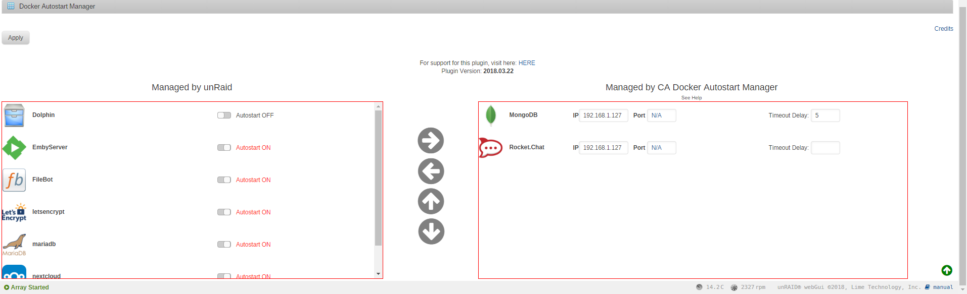

Having a similar problem.  Every time i save the configuration and reload the page or navigate away and then back all my settings are missing.  I'm not receiving any errors when I save.
I have attached a diagnostic zip if it helps.
tower-diagnostics-20180702-1117.zip
No good answer.  It works for me 6.5.3.  Are you hitting "Apply"?
Yep, make change, hit apply, get dialog confirming changes were saved.  Reload page and settings are gone.  I'm still on 6.3.3 with an update scheduled in the next couple days.  Ironically I was attempting to install this plugin to help manage startup of Dockers after the upgrade.
I will report back once I'm on 6.5.3 to see if that clears it up.
Just updated to 6.5.3 and settings are still not being saved.  I uninstalled and reinstalled after the update just to be certain.
/flash/config/plugins/ca.docker.autostart/settings.json
        "name": "MongoDB",
        "delay": 5
        "name": "Rocket.Chat",
        "delay": " ",
        "port": "",
        "IP": false
The value I entered for port was 27017 and the delay was 90.  Neither appears to have been saved.  Not sure what other troubleshooting steps need to be taken.
Thanks
        "name": "MongoDB",
        "delay": 5
        "delay": " ",
        "port": "",
        "IP": false
Thanks
Try it again and take a screen shot and the resulting settings.json file
        "name": "MongoDB",
        "delay": 5
        "delay": " ",
        "port": "",
        "IP": false
Thanks
I'll need to update the plugin in the next day or so to fix this.  In the meantime, you can rename the container to get rid of the period and it'll work.
