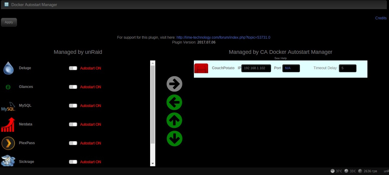

Untitled.thumb.jpg.3b9dc7193e41b9964154b592a670c1c9.jpgI have one question in regards this plugin.
When you move a docker app over to be delayed it has an IP but has NA in the port section.
Does that mean I have to give it the correct port or will it use the default ports?

If you don't give it a port to check against then it uses the timer

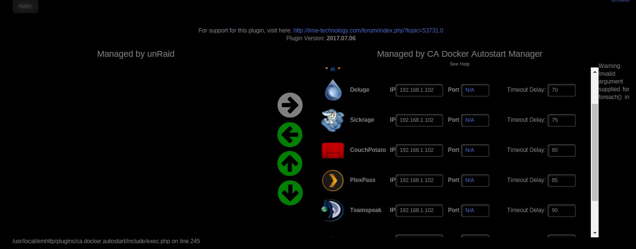

Are the errors anything to worry about? And I assume the time delay is in seconds?errors.thumb.jpg.6e5f3e6818afae918388b90e42d3f4d5.jpg
I'll have to look at it.  What version of unRaid?
6.3.5
If you need any log's from me just give me a yell.
Error displayed now fixed (appeared if all containers set to managed start).  Time is in seconds.

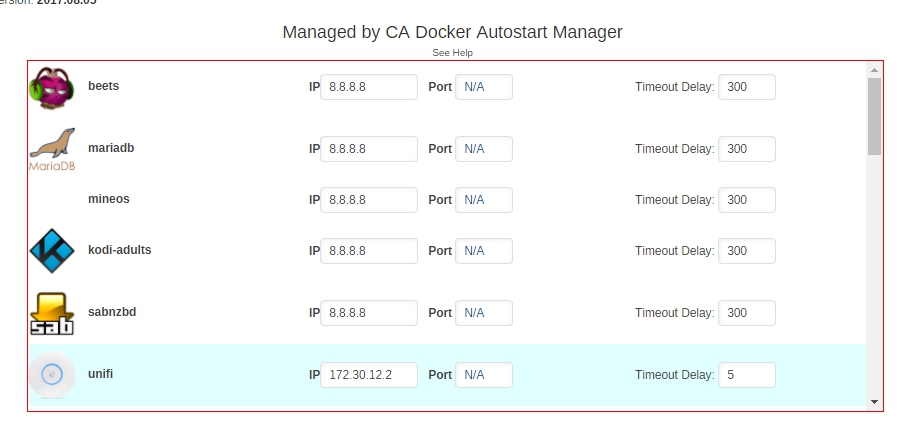

Can I check I'm setting this up correctly please.  I have a pfSense VM and I'm hoping this will speed up/smooth my start-up times by making dockers wait until the VM is running before trying to start.
What I'm trying to achieve here is:
  1. Don't start beets for 5 mins unless internet is up - does't need net until I use it
  2. If internet still not up, wait another 5 mins before starting maria db - doesn't need the net.  Otherwise, start immediately???
  3. If internet still not up, wait another 5 mins before starting minos. Otherwise, start immediately???
  4. If internet still not up, wait another 5 mins before starting maria db. Otherwise, start immediately???
  5. Ditto with sabnzbd
  6. After all these potential delays have played out, my unifi docker will come online so my wifi devices can start picking up IPs
Thanks
Thanks
Without filing in the port number, how you've got it will result in a strict time delay between containers.  I would guess you need to put in 53 into all of the ports (but leave unify with no port entered)
thanks - will do.
