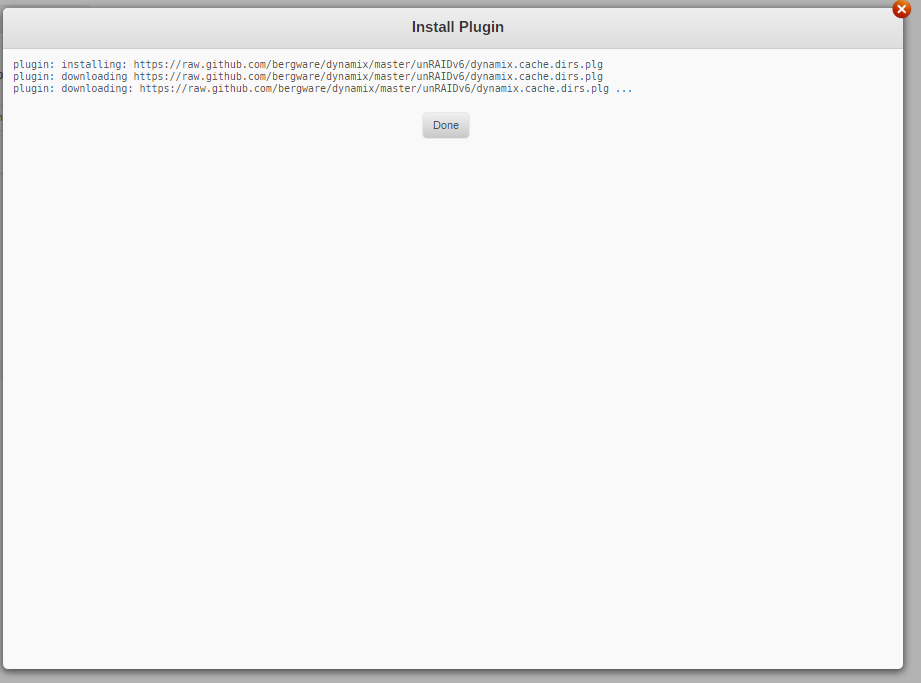

Whenever I try to install a plugin through the Dynamix web GUI, it inconsistently fails, as in, it always fails, but with different results.
I have attached an example error.

That's a very good idea actually. I tried it, and it seems there's no DNS problems.
When trying to install, it seems like, it tries to install the plugin, and just stops prematurely. Not quite sure what's going on.
