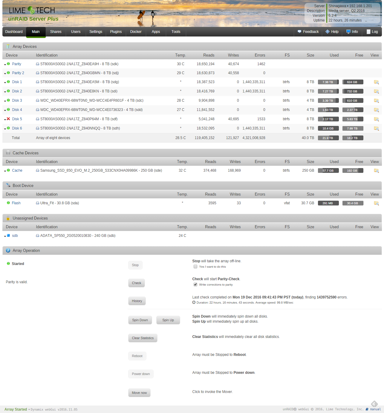

I am having a terrible time with unRAID. In the six months I've been running my server, I've had a new motherboard fail (just over a month ago), a new cache SSD fail (last couple of weeks), and now a new drive—which I conscientiously pre-cleared—look like it's failing.
I just got the SSD straightened out yesterday, and then in the evening, there seemed to be a power anomaly (which I have never noticed happening before in the five years we've lived here). My desktop stayed on, but the server reset. Seemed to boot fine, all the drives came up, but of course it hadn't been shut down properly, so a parity check was recommended. So I started that, and then went to bed.
This morning, one drive is marked with an 'x' and "device is disabled, contents emulated." But the parity check kept running until just now (14 hours or so later). The Main screen looks... not good. (Screenshot attached.)
I'm getting very, very, very, very tired of the stress associated with wondering if I'm going to lose data, and wondering what to do in what order to make sure I don't screw anything up. Could somebody please talk me through this?
(Oh, and before you think it: the UPS has been ordered.)

You didn't post your diagnostics but there are errors on multiple disks, so almost certainly a controller issue.

I guess I'm using at least three controllers: two PCI-E cards (two different brands), plus at least one on the mobo (might be two?). Are you suggesting that if a controller is bad, I could move drives to another controller, and all could be well? That would be pretty great.

Looks like my controller topology is:
- all four 8TB data drives on a Vantec controller
- both 8TB parity drives on an Iocrest controller
- both 4TB WD drives on the mobo controller
- unassigned cache drive also on mobo controller
If a reboot doesn't change anything, then should I perhaps move drives off the Vantec controller, and onto something else (I have another Iocrest controller, plus space on the mobo and existing Iocrest controllers)?
What else can I provide to help make good decisions?
Looks like this one is the problem then, if it's a Marvell controller and you don't need VT-D disable it.
Rebooting will clear the read errors and should bring all your data online, but disk6 will neet to be rebuilt.

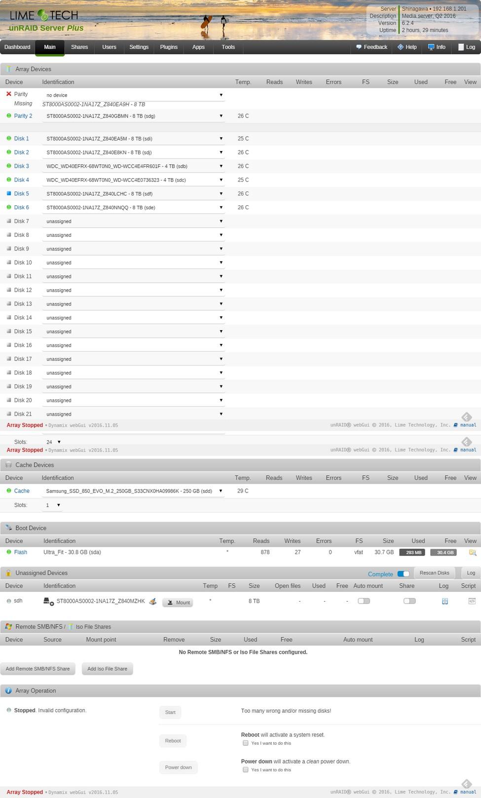

Took out both Disk 5 and Parity drives. Put two new 8TB drives in.
Assigned one drive (serial ending LCHC) as Disk 5. Ran Short SMART test; completed without errors; SMART report attached.
I've left the other drive (ending MZHK) unassigned. I see it in the choices for Parity, and also under the Unassigned Devices plugin section.
Now, how exactly do I go about rebuilding Disk 5? I don't see anything obvious. unRAID says I can't start the array: "Invalid configuration: Too many wrong and/or missing disks!"

Just checking that Parity 2, Disks 1 to 4 and 6 are all present and showing a green status. Disk 5 is a new disk with blue status and Parity 1 is unassigned? And that you powered the system down to replace the drives (ie. no hot-swapping)?
Yup. Just like that: no hot-swapping, blue status on Disk 5, green on everything else, Parity 1 unassigned. Screenshot attached. (Man, that 320kb maximum is unnecessarily stringent: I can't even get a full screenshot at original resolution into that size!)
That's probably a bug, try this:
-set disk5 to unassigned
-leave parity1 unassigned
-you should now be able to start array
-stop array
-reassign new disk5
-start to begin rebuild
