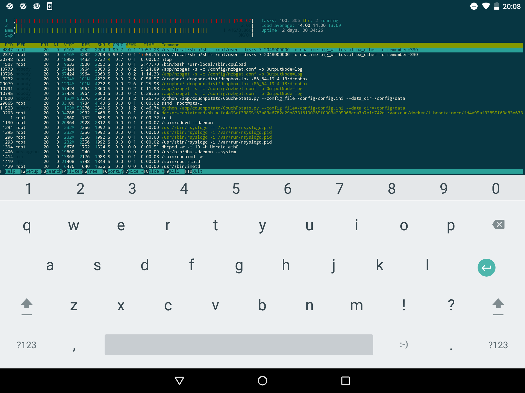

I have this issue as well. How can I kill the process and restart? kill pid is not working.
tmp_11093-Screenshot_20170213-2008381733737311.png.36c30cb601a2c467c4180dd73b00fb1f.png

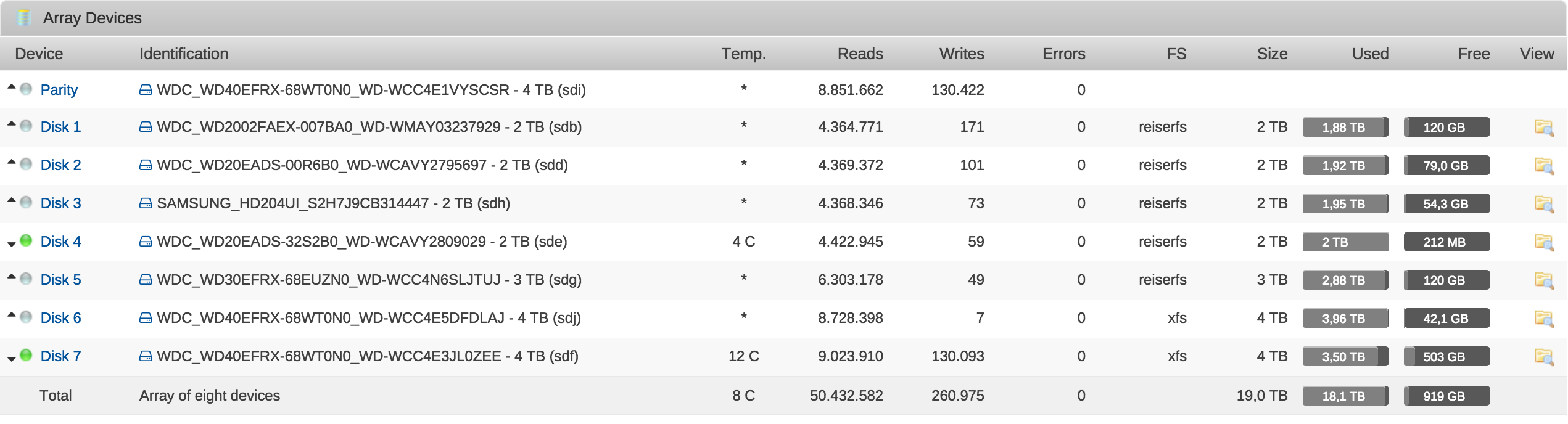

I'm seeing the same thing, no cache_dirs plugin here, and yes there are ReiserFS shares.  Seemed to happen when I tried to delete a bunch of files, but that may be coincidental.

This is happening to me also but all my filesystems are XFS. My server with run for about 2 days then the load goes through the roof and I can no longer run any commands or shut off. I have to hold the power button to restart.
You may well have a different problem with similar symptoms so start a new thread and attach your diagnostics zip (Tools -> Diagnostics).
i'm having similar issue:
100% shfs and all my shares/drives are reiserfs.
poweroff, reboot are non responsive. the only option i can do is to manually turn off my server which will trigger the 10+ hours of parity check. On top of that, i'm also getting some errors when parity check finishes.

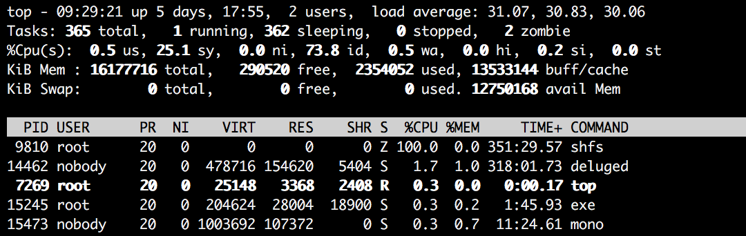

I upgraded to 6.3.1 and had the same thing happen last night. Definitely a new problem introduced since 6.2.4 never did this.
