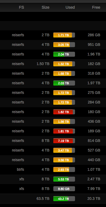

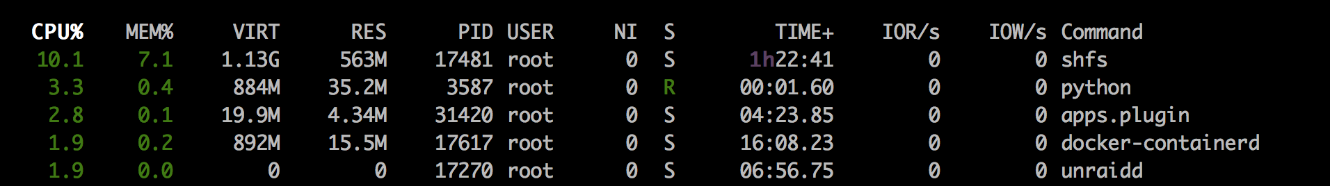

I've been having the "100% CPU on shfs, everything unresponsive" about once a week, and having to hard reboot.  Been happening on all of 6.3.x's (including the current 6.3.5), is the only thing I don't love about unRaid.
I have almost all reiserfs drives, guess it's time to start the slow migration off...
That's exactly what happened to me. How much free space do you have altogether on all your data drives? Post a screenshot of your Main page of the GUI if you want a gameplan to start the process.
Also, do you keep strict control over which files / shares reside on which slot number?
Attached - You can see the last drive is an empty 8TB - that was my precleared hot spare, I just added it in, formatted as XFS, and started moving data from my smallest drive over.  I figure I'll move a few 1.5TB/2TB drives onto there, then xfs them up.  I also have another 8TB spare (precleared, but no room to plug in - was going to keep for next time a drive died).
Nah... occasionally I use `diskmv` to load balance them so related folders are grouped, but don't have any per-drive shares.

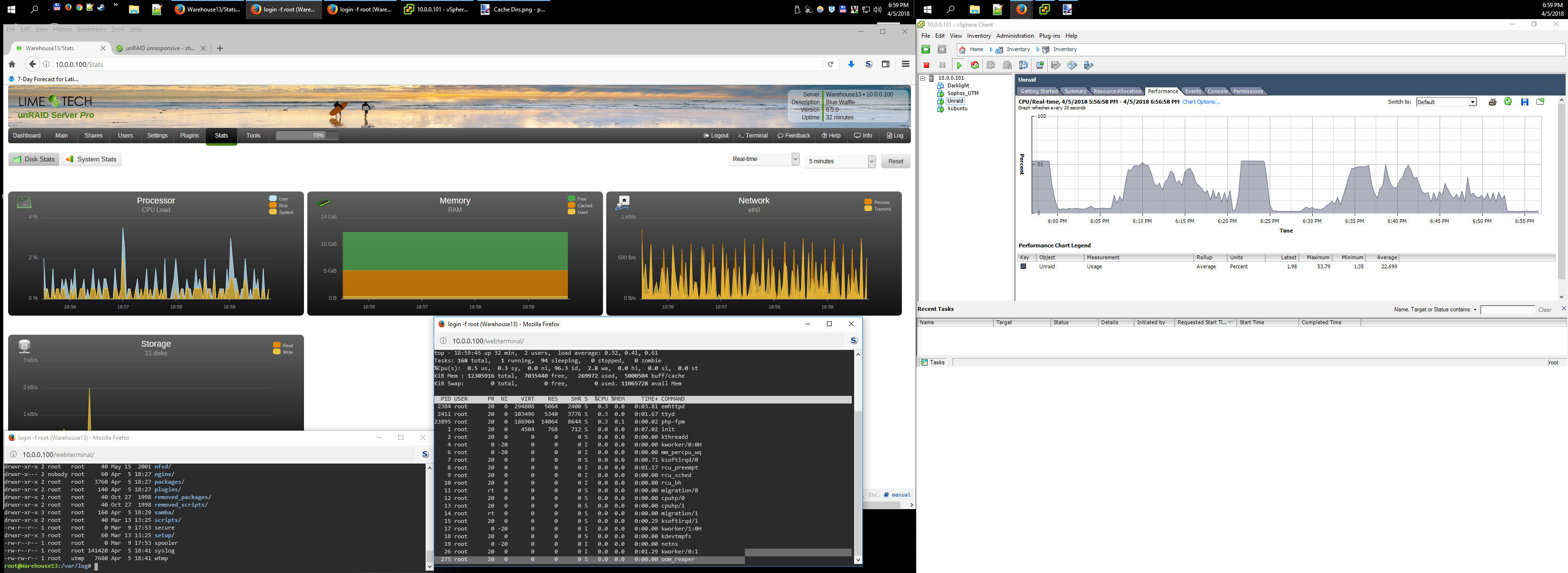

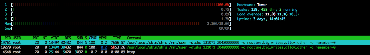

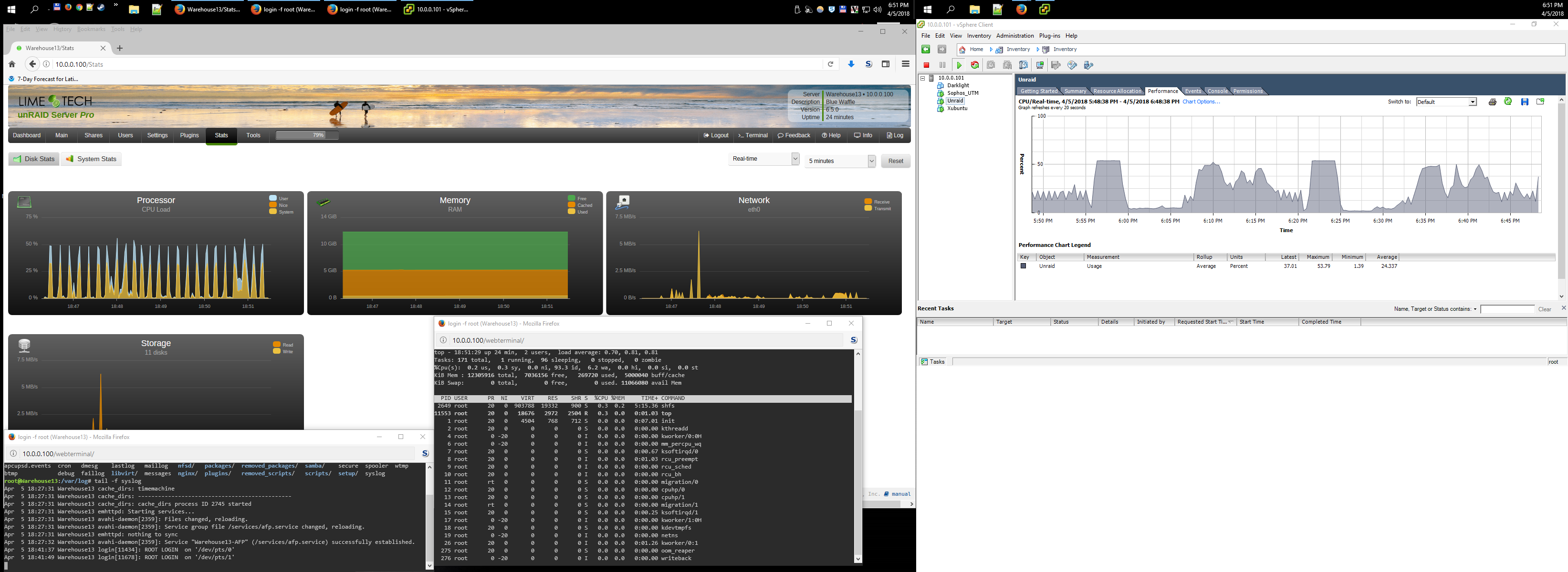

I just got this on 6.5 stable, and ultimately I found out it was cachedirs causing it. I'd spike to 50% cpu usage every 2 seconds (on a 2 cpu system). As soon as I removed CacheDirs it went away.

Now after removing CacheDirs.

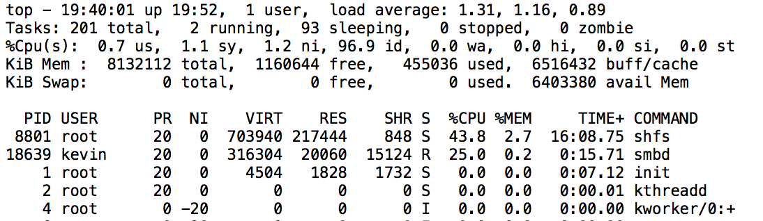

I'm running with 6.5.0 now and experiencing the same issues.
I've also disabled VM's, all except 3 dockers (teamspeak3, plex and plexpy were still running). I've also removed CA Auto Update, since it's known too cause problems for some users.
I've copied 6 files today (with a total of around 5GB). Explorer.exe in Windows agains keeps hanging cause it gets no response from the unRAID server. Transferspeeds drop to 0bytes/second for 10-120 seconds and then spike to 5-25MB/s (instead of 112MB which I used to see).
While this problem is happening, the unRAID GUI remains working. As well as connecting via ssh.
So I was able to run the diagnostics command using ssh aswell.
See attached files for the cpu+mem usage of shfs (cpu time is 16:08.75) from the diagnostics zip (top.txt) and the transfer speed I'm getting while copying a file.
