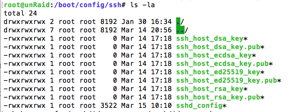

Check the contents of /boot/config/ssh, do you have zero bytes keys there?
Hi Gubbnutten, yes all zero bytes here...not good I guess. Any thoughts on how to resolve?
Cheers, Deeks
By the way, here's the screenshot... just beining curious, what do the asterisks behind the file mean?
Cheers, Deeks
Should be safe to just delete them and restart the server.
After reboot the deamon was running again. All I had to do was edit known_hosts on my macbook from which I usually connect and throw away the lines referring to my unraid box. Now I can connect to SSH again.
